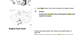

Hi again Lou...you helped me a ton back in the Winter with my first winterization. I am ready to de-winterize and curious if you could let me know what I need to do?
I believe I just need to
- Take the hoses off the raw water pump, fill them with water (I did not use AF, so they are empty)
- Check the oil
- Get the hose attached and running (outdrive still off)
- Start her up!
Is that correct?
Also, just to make sure I didn't mix the raw water pump hoses when I took them off to winterize, can you confirm that on the Volvo Penta 4.3 GL, the hose coming from the transom should connect to the top of the water pump?
I guess this is pretty clear from the manual, but just want a sanity check
Thanks
Lou C
Nov 10, 2002
14,516
yes based on that pic, the hose coming from the transom mount should be the top one (water flows into impeller housing).
Ok I'd make sure that your drain plugs are all in (each side of block, and exhaust manifolds) and I would fill each of the hoses for the impeller with water before firing it up. The one from the impeller to the 'stat housing, I would disconnect it at the 'stat housing and fill with water, then re-connect. The one that's from the impeller to the transom mount, disconnect it at the impeller housing and fill with water. Now this might seem extreme but it's what I have done, IF the engine was drained and is empty.... fill the engine and manifolds with water too before starting. For the engine all you have to do is disconnect the big hose from the front circulating pump at the stat housing and fill the engine with water till it spurts out of the stat housing neck, then reconnect. For the manifolds, just disconnect each feed hose at the stat housing and fill each manifold with water till it runs out the exhaust housing on the bottom of the transom mount (you'll hear it running on the ground). Reconnect the hoses, hook up the ear muffs, turn on the water and fire it up.
