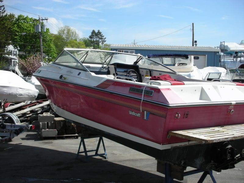

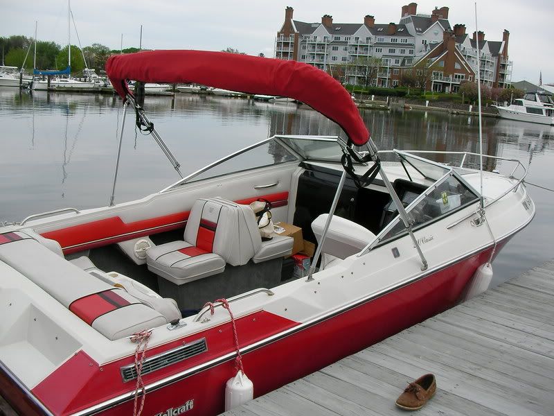

I debated this last spring, and decided instead to wet sand, compound, polish, wax, rinse, repeat (j/k). I spent hour upon laborious hour with this project, and the results were mediocre. I definitely saw an improvement in my faded red (it was truly pink when I started), but the results were "splotchy." - that is, nice in some areas, but mixed in with white/faded spots all over. It looked good (great considering how bad it was) at the beginning of the season, but after a couple months in the sun, it was back to being fairly faded again. Want to see?
Before
After
Keep in mind, it now looks much more faded. In that "after" picture, the boat looks really good from 10+ feet away, and "meh" up close.

BTW - the pictures do not look too bad. I had a maroon '88 SeaRay, pretty similar to your boat is color and color scheme, and my fading was much worse. I used to burn thru two cans of rubbing compound on a power buffer and get really lousy results. Did you ever try some of that polish that is suppose to seal the gelcoat, and give it a wet shine look? I never tried it since it was pricy, a lot of elbow grease and I had very little faith anything could save my boat's finish.
