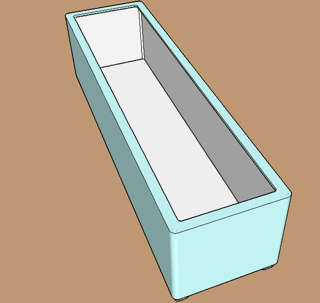

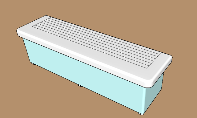

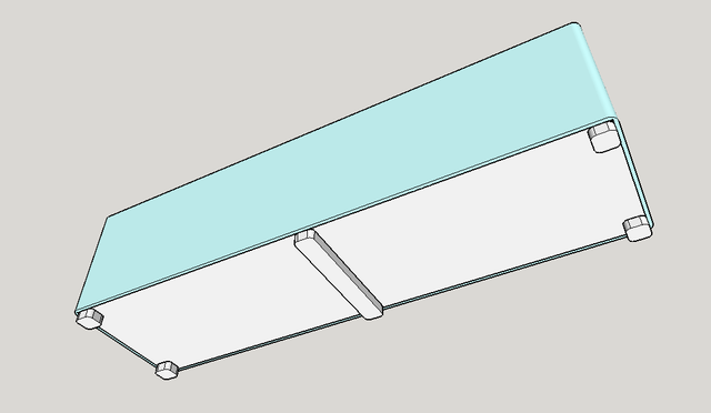

I was thinking something like this. The backrest will be attached to the gunnel. Feet will be some 1" starboard I have laying around.

So, you are talking about the frame for the seat not necessarily the upholstered base. In this case, here is a different approach for your consideration....
Go to Costco and buy the longest and the highest quality cooler you can find. Attach the upholstered base (the white one in the picture above) to the cooler's cover and you got your seat but also you got the cooler which you can use on the boat or convert it into a live well or even store things in it. The cooler is plenty strong and will end up much cheaper than you building from scratch when you consider the cost of material to build and finish (paint or gelcoat) the product. Just a thought.

if you want light weight, DeepBlue's suggestion of a cooler is spot on. infact the local marine surplus sells them with upholsterd tops on for that reason. However if you are bound and determined to make it yourself, the lightest commercially available reasonable cost core out there is nida core. it is a honeycombed fiberglass panel that you can put a layer of glass over the outside and inside and have a super-strong, super light weight box.

Ahhh, Now I see what you have in mind. The cooler Idea is a Great one!!! But as stated, If you just HAVE to build one then, 1/4" ply banded at the edges with 3/4" cleats and then glassed or heck just epoxy coated should be plenty strong and light weight too. A Gallon of epoxy should do the trick. I'm thinkin' this thing could be build and upholstered for about $150 bucks. The largest ones my googling turned up were only 48" wide. Not sure they make 60" wide coolers but I've been wrong before.:eek::D;)
