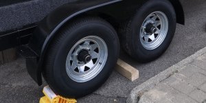

I was thinking of buying a spare wheel hub in case one bearing fails far from home.
Is it something that happens often? I grease my bearings twice a year.
Are there many models in the same manufacturer for the same capacity?
My axles are Dexters 6 bolts, 5000 or 52000 lb each, with a 6'' drop.
I want to make sure I buy the good part.
Here are some pictures of the axles I have if you guys know what they are.
PS: the spring leafs have been fixed since then.

I would consider it nice to have but not an absolute necessity. For only a simple bearing failure having a hub already set up would make a change go a lot quicker as no need to drive races out of the existing hub. Not a break the bank item to carry on long hauls so it may be worth it just for peace of mind.

If you’ve got 4 wheel brakes you can just buy one more 12” drum and a set of bearings. Remember you have to figure out if you have 5200 or 6000 hub drums. The inner bearings are the same for the two but the 6000 hub has a larger outer bearing

Yes, I'm planning a long haul and it it happens, it will be a parking lot repair, so I will check prices.
Yes, 4 wheel brakes, but I would prefer to avoid to change bearings on the side of the road, that's why the hub looked like a good solution.
