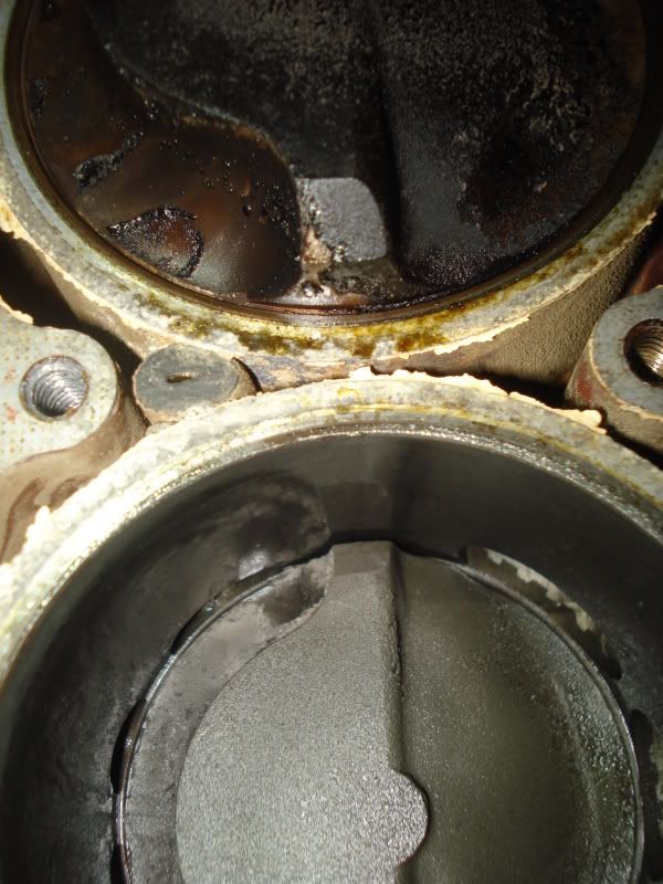

is this a crack in the head gasket? or are my eyes failing me..... if so you have found the cause....

I didn't notice any cracks but could be. If it were the cause, injecting oil in the cylinder should not have increased the compression if it were a bad gasket. Thats only for rings right?
I have new gaskets coming in from my iboats order tomorrow. I hope to get the new gaskets on eventually. Too many things going on. I'll post up the results if I get any improvement on compression. As of now, I expect the same numbers since the cylinder wall is scorched a bit.
Considering the age, what are the chances the factory sealed heads have never been pulled in 31yrs till now!:D Paint was not cracked between the bolts and cover and no tool markings. That's a tough little motor!

Compression will improve most noticeably in the leaking cylinder(s?), compressed charge will not escape, water will not enter, allowing proper ring lubrication. The oil in the fuel will do it's job and the ring seal will improve now that oil isn't being washed off. The excessive wear on the bad cylinder will show as the pressure difference on comp test post repair, not 100%.
Do your best to clean mating surfaces. Do not wire wheel or gouge them, hand clean with solvent, rag and a dull putty knife if you need it. Fine/medium scotch-bright pad is OK to use by hand, no power tools on aluminum.

From my previous posted image, the bottom cylinder has a silver buildup on the top half of the cylinder. Plus the cylinder is obviously "silver" and eating away on the powerhead. See pic below:
Basically, Mechanic A told me to replace head gasket, check compression, and it looks like it's running lean and might need need a carb rebuild or have clogged jet on that cylinder. If running fine after head gasket replacement, keep running it and keep close eye on motor temp and compression. I should probably mix the fuel a little richer since all the cylinders are running lean. (he looked at the plugs since they are all black and dirty.

No mention of water by mechanics?
The silver is wear from loss of lubrication due to steam cleaning.
I don't see detonation damage, there is some slight pitting but that would be expected for the age. Plugs would also not be as you described if it were running lean and detonating. Don't run more oil than 50:1, even if it was running lean, that won't solve a lean condition. That actually could make it leaner. Lean is from lack of fuel for the amount of air being burned not lack of oil.
You should proceed as planned. The mechanics want you to spend money.

You can't see the detination very well in the picture above. It looks like stuff is stuck to the top of the piston. I'll take another photo while I have the heads off.
I agree, I think water caused this problem. I should probably replace both head gaskets to prevent further damage on the other cylinders. The mechanic was a super guy and could tell I'm trying to do everything myself. He told me that I should rebuild the carb or inspect it to see if the clogged jet was causing the cylinder to run lean. He really was trying to help and not get me to "buy services" from him. He was impressed with my boats age/appearance, the current performance (considering) and wished me good luck. Pretty cool guy really considering how busy he was on an early Sat. morning. He said considering it's age and if it were his, he would proceed as you have noted (replace, recheck, test) and if the numbers didn't decrease, keep running it and to check frequently. As long as the warning buzzers work (he showed me how to check that too), everything should be OK.

Looking at the pic of the head, I noticed ALOT of carbon built up on the head at #4 cylinder. I also agree that the head gasket is damaged and allowing water to enter that cylinder.
So, this is how I see it. The weak coil allowed carbon to build up in that cylinder due to not giving enough fire to burn all of the fuel/air mixture, making it run rich. You had your mechanic do a decarb. This loosened up the carbon in that cylinder and may have caused a weak gasket to pop and allow cooling water to enter the cylinder and "steam clean" the piston. This will also cause a lean and poor combustion in that cylinder. The fuel mix becomes diluted and can cause ring damage. Water isn't a lubercant. I believe you caught it before it could clean the head entirely. I bleieve there was more carbon there.
Now you have replaced the coil and will be replacing the head gasket taking care of both problems.
The main concern now is the low compression in that cylinder. Try this, while the head is off. Spray deep creep(sea foam in a spray can) all over that piston making sure the piston is covering the intake and exhaust ports. I believe, and sobody will argue with me I bet, that the rings are still hung up
I see no scoring or damage to that cylinder. I actually wish mine looked that good!!
Put it together and run it. Keep an eye on that cylinder. You have done it right. No mechanic needed.

1st photo of early detonation damage, may be argued pre-ignition, could be both.
2nd photo of severe detonation damage of motorcycle piston.
3rd photo of spark plugs general condition.

Gap the new plugs correctly and run it a day on the water and pull the plugs and post plug photos, you can tune from there. Your tune is pretty good as it is, don't over oil.
The deep creep SeaFoam shouldn't hurt anything, you can use it to help break down the carbon buildup while the heads are off. Don't go nuts using it, shiny doesn't go fast.
Based on the photo you posted(attached), I think your rings are OK but you can't see them all the way around. I assume this is #4 cylinder. The black/brown towards top is from blow-by, but they don't look stuck and the blow-by should improve once oil isn't being washed away.
