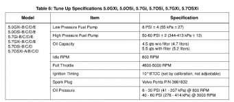

I would like to change my spark plugs.
In the Volvo manual, for a 5.7Gi-D, it is listed as 3861632
On the engine block name plate, it is listed as 3851632
And what is installed right now from the previous owner is AC 41-993
I would like to go with the same AC plugs since the boat was running fine. But I just want to make sure it's the good one since I don't have a cross reference chart vs Volvo numbers.
I'm curious to know why the manual says something different as my engine name plate.

volvo doesnt make spark plugs, they buy them. they assigned a part number to the AC plug that came in the motor from GM to begin with.
should be AC delco MR43-LTS The M stands for Marine (stainless body)
the 41-993 is an iridium spark plug with a nickel alloy body. it will be fine for the application and should last about 20 years of normal usage.

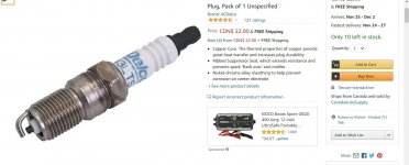

Regular plug at $22 CND each because of the S.S., or Covid, may be because in Canada, who knows.
I will check my local autopart store for the AC 41-993

Scott, the attachment picture of the plug was on Amazon.ca
Sometimes some merchants are way out of price.
