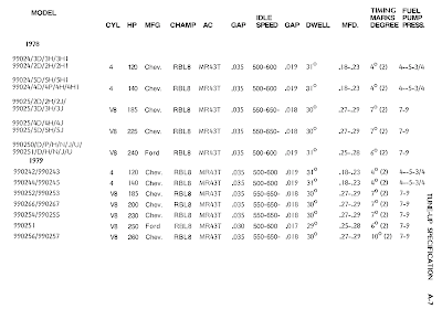

It's a 200 HP Chevy V8 motor (305 I think). Here's the specs from the Solec manual (get one if you're going to be working on this or better yet, get a bonafide OMC shop manual).
You can click the images to get the full-sized versions:
