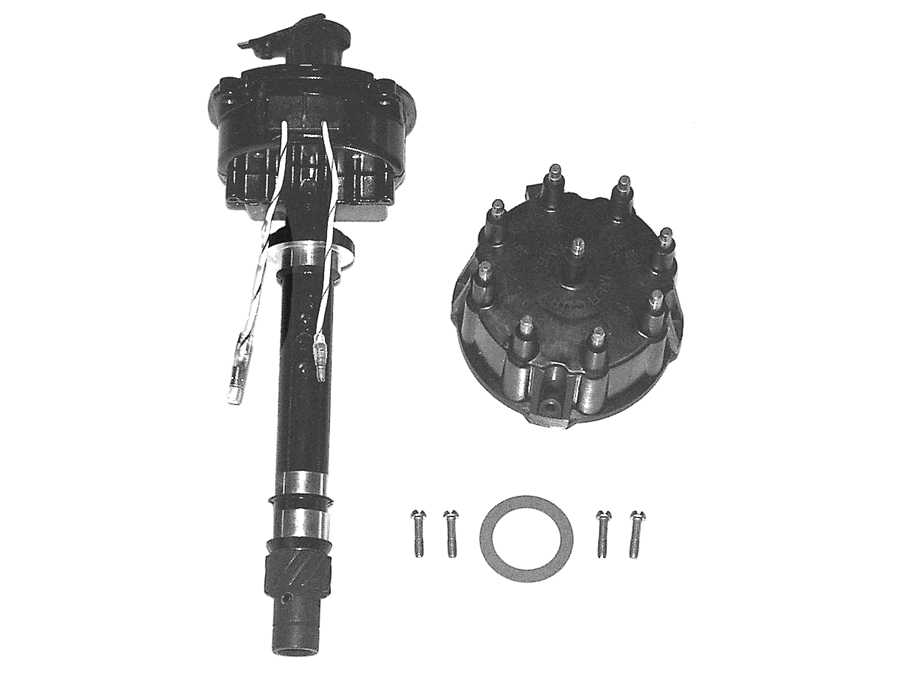

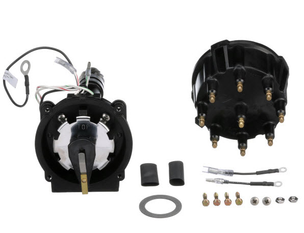

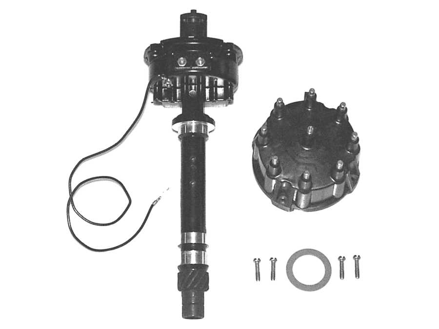

1 — 90747A27 — DISTRIBUTOR (1 required per assembly)
90747A27 - DISTRIBUTOR ASSEM  - Replaced by -805185A43
90747A27
90747A27 - Distributor Assembly [ More info ]
Unavailable
805185A43 - DISTRIBUTOR ASSY   - Replaced by -805185A36
805185A43
805185A43 - Distributor [ More info ]
Unavailable
DISTRIBUTOR ASSY 805185A36
805185A36
About Mercury Marine
OEM Part
805185A36 - Distributor Assembly [ More info ]
Add to shopping cart $462.79
Available to Order: Usually ships within 10 days.

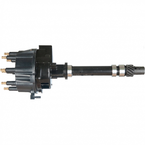

THUNDERBOLT IV V-8 DIST
18-5470
About Sierra Marine
OEM Match
18-5470 - Distributor, 805185A37 [ More info ]
Add to shopping cart $460.99 $383.14
In Stock
