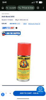

Anyway, I've been trying to get this 'bonding plate' off the transom for the past few weeks. In our discussions of 5200 adhesive, if it is 5200, it must be the good/old stuff. It held on with all of its might until I cut the last bit of it. In trying to pry it off, the thing just laughed at me. So, I reverted to cutting the adhesive with a variety of sharp tools.
Also, in our discussions of fiberglass cloths, who would venture to say what cloth # is that shows on the transom? :unsure:
With the plate out of the way, I can do the grinding in preparation for the transom supports.
53,077
5015 debonder from worst marine works to loosen the bond of 5200
