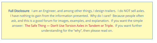

It's actually more than my opinion.
Synopsys of the article:
There is a good reason why torsion axles get their spindles bent frequently. When one wheel goes over a bump or drops into a hole, one axle supports ALL the weight for a moment. Leaf spring trailers don't have those issues since they have the equalizer between the spring sets.
Also, you will always have more tire wear on one axle, even if the trailer is level since you don't have an equalizer. If the trailer is not perfectly level, it will be even worse!
No squeaks from my travel trailer with all wet bolts installed.

Also read the section on that site where he explains the difference in how the force of the weight is transferred from the axle to the frame, torsion vs springs. With the springs the force is spread out along the frame (each one has two mounting points) but with torsion it is concentrated all in one place. That, and the inability to load share when the one axle lifts off the ground are the drawbacks of torsion besides the much greater cost, and inability to repair them. With springs, your springs rust or sag, you simply bolt up a new pair.
https://mechanicalelements.com/torsion-axle-conversion-plans/
He goes on to show how torsions can be made to load share with a design called the walking beam, very interesting, but I have never seen that done on a boat trailer.
