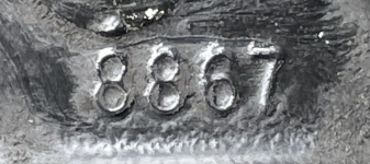

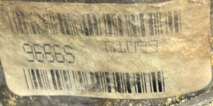

Please help identify model info:

Ayuh,..... It appears to be the Merc/ Weber AFB carb, which is a carbon copy of the edlebrock 1409,.....
For a rebuild kit, or other parts, edlebrock is cheaper than Merc parts, 'n just as good,..... better maybe,.....

are rebuilds "swappable"? is reman worth the savings of new? what kind of adjustments are required?
thank you!

Rust on the outside is not really an operational concern it’s what you see when you open it up. If there is a lot of alu corrosion inside then replacement with the similar Edelbrock may make the most sense.
Is this compatible with the 1406 or other part number? Trying to source a local replacement.
Thanks
Thanks
If you are talking about locally sourcing a carb 1406 is the edlebrock automotive carb not rated for marine use you need a 1409 which is the marine version.
if you are talking about locally sourcing a carb kit yes the kit that fits the 1406 is the same for the marine carbs and is commonly on the shelf at autozone/advanced auto/ pep boys.
