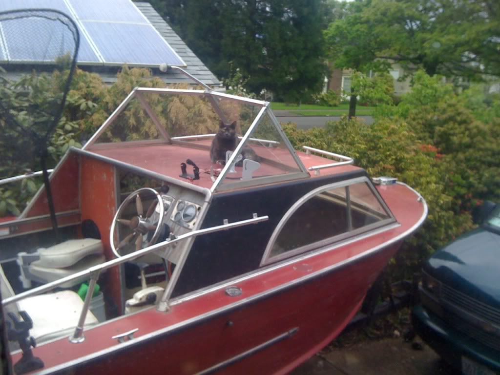

I'm going to replace the floor and do some other repairs to the 'chief, but my axle is too wide for the garage. I've seen some folks on here rig up dollies for SC hulls, and I'm wondering if this would be safe to do with the motor still in, or if the weight of the motor will compromise the hull? Rain is in full swing here, and I know the only way I'll work on it will be in the garage.

EDIT: I just noticed that cat sitting on your rig there ^^^^. I think some 80 grit sandpaper and acetone should clean that right off. If it's real stubborn just grab the wire wheel or a sawzall, should do the trick:D

Yeah, that's First Mate Scotchy. She LOVES hanging on the 'chief. The Admiral thinks (based on the First Mate's proclivity for tuna) she should come out fishing with us. I'm a bit less optimistic of the logistics of such an operation. I do confess a willingness to see First Mate in a tri-cornered hat, however, and arrangements are being made.
