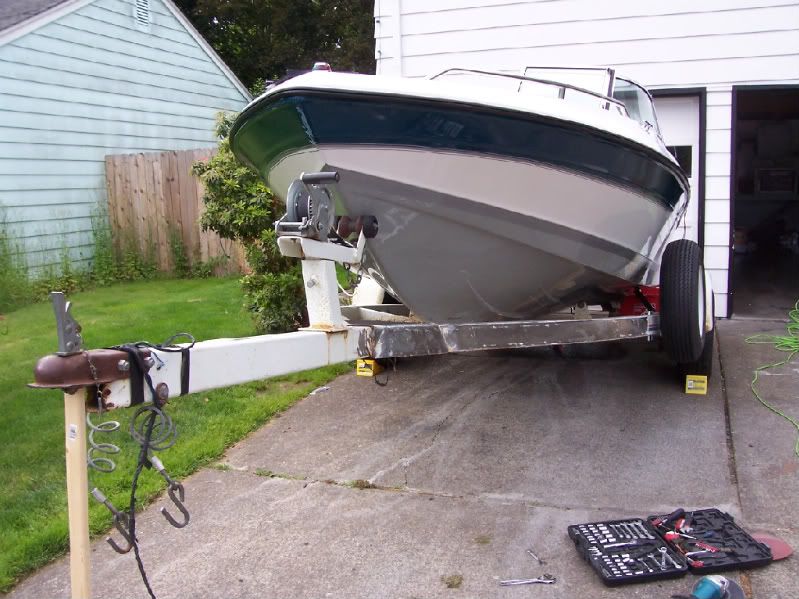

The only known pic of the boat prior to recon.....The work being done on in the pic was the trailer paint being cut off with a angle grinder and 36 grit paper..comes off like butter.
