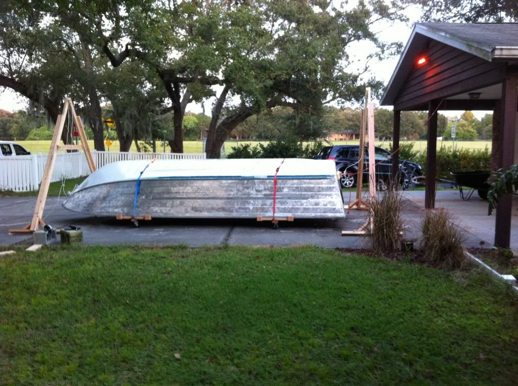

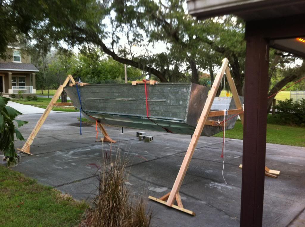

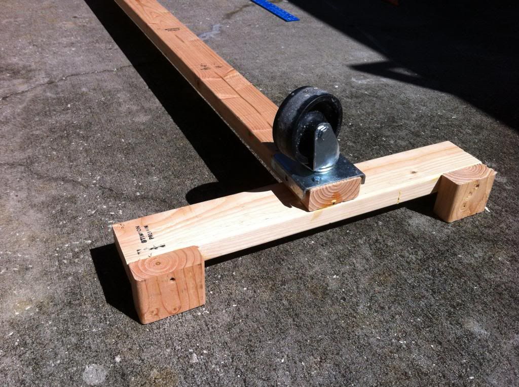

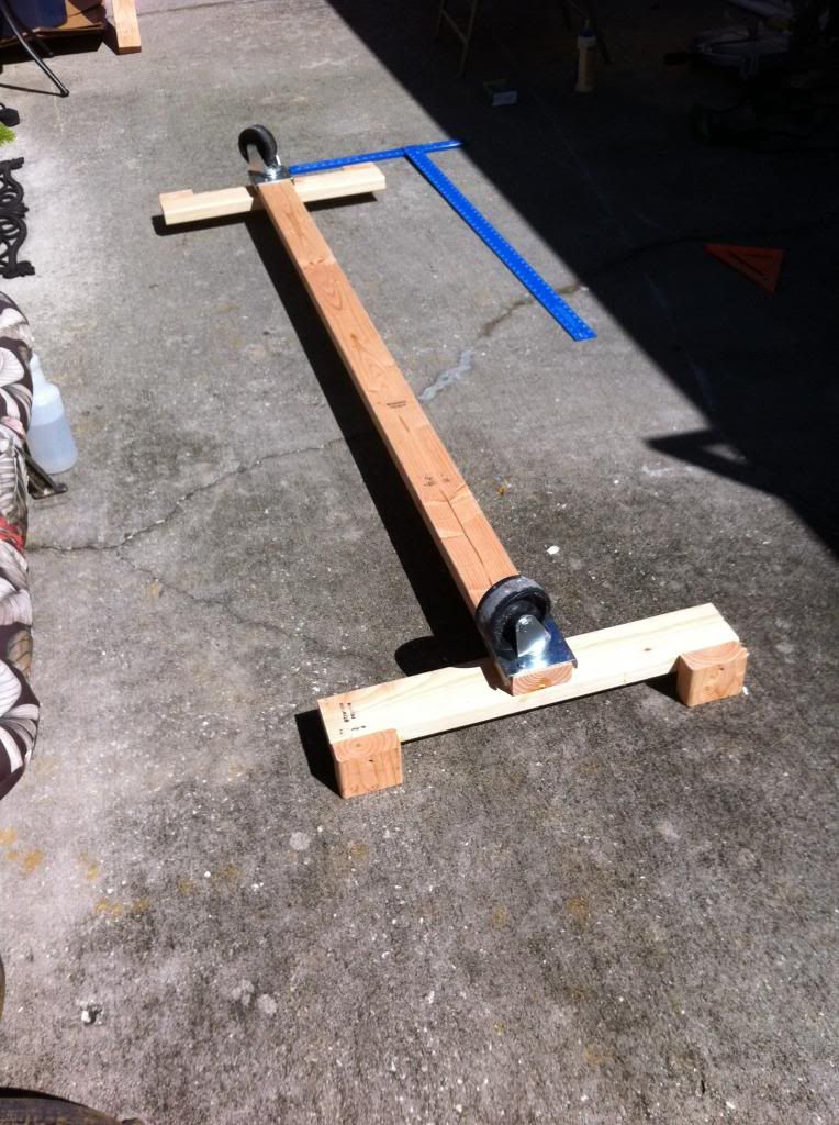

I focused on the waterline and up for now since the craft was still on the trailer. But I was making good progress and knew time to flip the hull was coming fast. So I started by making a couple of "carts" that the hull can ride on whilst upside-down:
Basically a set of caster wheels on 2x4 carriers. Also will serve as a support braces when actually flipping.
