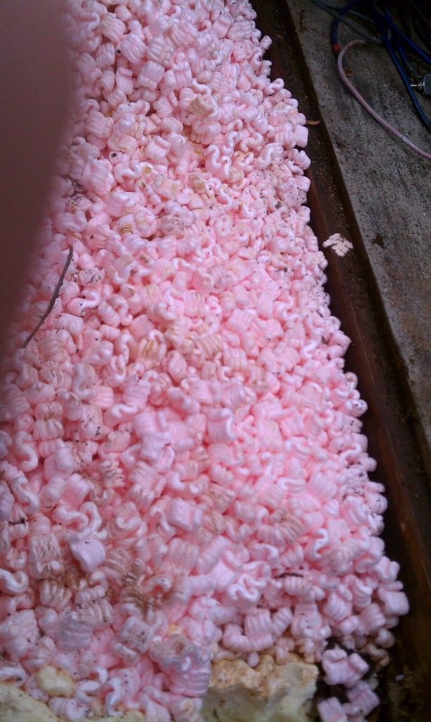

Well, the rehab has officially started....
Seats, batteries, carp wood set into factory seat brackets has been removed, carp deck/sole removed and I am now carp 'pink styro peanut' rich, oh joy joy.
:facepalm:
At least the installation & workmanship for the plywood & spray insulation foam was all done in an exceptionally poor fashion and were definitely an unapproved non-iBoats method/process.
The 2 2/3rd sheets of plywood must have each weighed 15-20lbs. And the doubled TREATED 2X6 tapered stringer easily weighed 30+lbs. Ugh, the whole mess was a very inglorious assault on the olfactory senses
Although I hate the bed liner material, and it is defeating some of the limber holes, it seems to at least be WELL STUCK, and kept the PT ply & 2X6's from attacking the hull, ribs & rivets. I plan to attempt to pressure wash the interior hull and get a little more of the spray foam out of the bow & off the 2 or 3 ribs where it is still hanging on pretty well. In most areas it was very waterlogged & pulled free fairly easily.... So again the bed liner had some benefits......

Wow, pink peanuts, now that's interesting! Hope you had a big shop vac. At least it's lucky that the bed liner kept the PT away from the hull. Curious to see how that pressure washing works out, good idea. Several times during my project I wished I'd had access to one of those. Progress feels good!
barato2
Dec 7, 2010
2,956
Re: Starcraft I own, but haven't picked up.........
i'm thinking that a #1 Xacto would work to clean the bedliner out of limber holes....use the pointed blade to trim around the edges of hole and the chisel shaped one to scrape it out from underneath the rib.
those peanuts are a weird solution and not entirely a great one given the air space they leave between em...but at least you know you bought the boat from a fellow bottom feeder of sorts

No. No. I did NOT just see that someone used packing peanuts for flotation. :facepalm:

Yep, I think they took all the packing peanuts from 3 UPS stores:facepalm: and used about 8 large contractor cans of spray foam. The bow was quite a challenge...
3 FULL 45gal garbage bags of HEAVY, wet & fragrant foam peanuts....Those pix are just 1/2.... Ugly, but it is no more..........
I bet that mess all weighed 150+/-lbs.
