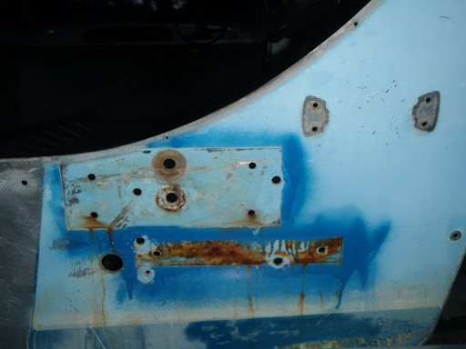

I found quite a bit of corrosion on the transom. It's very pitted and even goes through in two places. What should I fill those with? The transom also kinda looks like swiss cheese because of all of the hardware and plates they added to support the rotted wood.
Should I just through-bolt them with stainless?

That corrosion is from mixed metals. On the transom it is best to use an orbital sander and clean it up. You can fill the pitts up with jb weld, re-sand and even use gluvit if you like.
In the spots where to corrosion goes through..... is there wood behind those holes? Considering the power of the v-4 you might want a sheet of aluminum welded in.

Boatdr I would say through bolting with stainless bolts would work for the holes just make sure you seal the bolts when you put them in . I agree with Bob though if theres alot of corosion on the transom check with some local welders about welding in another piece of aluminum to the transom which would fix that problem as well as all the holes from things being bolted on over the years :D.

Also took her to get some welding done. Had the holes from the rod holders in the gunwale fixed. I cut out a piece of aluminum and had it welded in. They did a pretty poor job and let it get too hot and warped it quite a bit. Got most of the warping out. Good thing I'll be covering it a track for rod holders.
Also had the brace that was cracked welded:
As well as all the holes in the transom:
Now I am just sanding like crazy! Looks like almost all of the paint needs to come off. There are three layers of paint on the bottom that all appear to be chipping to some extent.
