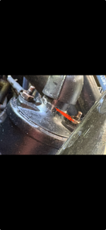

After poking around some and having someone to help me crank it over and check for spark I rechecked the spark at the spark plug wire and I will get one spark from the plug at the first initial crank and it’s gone.
From there I just happened to see out of the corner of my eye the coil arching out. It was coming from the postive wire to the center of the coil. I removed the coil and for whatever reason I had it upside down and there was liquid leaking from the center of it.
Do I just replace the coil and see what happens? Or did something further down the line fail and cause the coil to fail?

This is where the coil was arching out
Ayuh,...... That's where I'd start,.....

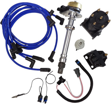

52,751
Thunderbolt distributor or EST?
If thunderbolt, does the ignition trigger have 2 wires or 3?
dubs283
Jul 27, 2005
5,346
That’s all I seem to be finding. Red/white green/white and an additional ground wire?
There's a fairly simple test to determine if the ignition sensor in the distributor is faulty. Surprised no one has posted the manual page
Once you've concluded the sensor is at fault, a new coil along with an OEM sensor is your best bet

If you want to upgrade the option from merc is the hei delco ignition and it works fine.
Takes some savvy and a dedication to install with an understanding of electronic ignition systems
You could always revert to some kind of weird aftermarket system but they don't work as well ime, if your t bolt module is newer/not square big box style the OEM ignition sensor will alleviate your no spark/timing issues

Why would you replace the ignition system if it’s working? The atB is a great system until the ignition module needs to be replaced $$$. Then typical replacement is a delco est. this isn’t any better except module rEllacement cost. Both are OEM quality systems.
Lou C
Nov 10, 2002
14,149
I would leave what you have as long as it's working right. I looked into the Delco EST to replace my points distributor but what I found is that it isn't genuine Delco but Sierra aftermarket. Don't know of all of the ones sold are like that but in my searching it seemed that way. Decided to stay with points for now. "Delco" EST is over $600 for a 4.3!
I found this out by emailing Michigan Motorz and that's what they told me!
Fun Times
May 16, 2009
9,362
Now my mind is wondering do I leave well enough alone? Or do I replace/upgrade the ignition system while I’m in there already
Sort of better to have an extra one on-board with the tools to change the sensor out should the need come to it out on the water.... Have a new rotor handy to as the rotor could get damaged during the R&R. https://www.mercruiserparts.com/bam/subassemblydetail/42256393/28171834
