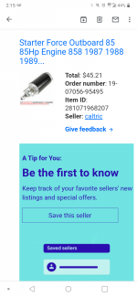

Well that rules that out then.what mine was doing sounds pretty close to what your was doing. The starter was engaging fine but would turn the engine over fast enough to crank.Then eventually it got were it wouldn't even spin fast enough to engage with flywheel. I replaced my starter and so far it has been good. I think I got it of eBay. If you want I can try and find the part # and where I got it. Sounds like you may have got a crap starter. It happens unfortunately
Poormansboating
May 18, 2021
238
That's the one I used and so far so good.my engine is a1989 85 hp
