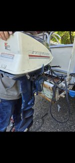

Trying to get my pontoon to run. Need to replace the starter on '69 25903b evinrude . Bough 3 aftermarket " replacement " starters for the 4102m but the bolts don't line up to the mounting bracket!!! What do I do now???

Victim of the internet---" everything fits "---Syndrome.-----You need to find a factory starter.------From 1960 to 76 fits.
39,222
A starter from a 22 cubic inch motor.-----Marketed as an 18 / 20 / 25 HP beginning in about 1960 to 1976.
