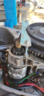

Good news on two issues.
The starter motor, mounting issue is resolved, installed 1/4" screws 3" long in the two front manual recoil start mounting holes, used a nut on each to determine the height needed to clear the fly wheel, started out using 3/4" aluminum angle from screw to screw to hold the starter motor in proper working location. Had to relieve a portion to clear the fly wheel, and also remove most of one side of the angle, to clear top of hood inside. So will use the prototype to make a neater one, from 1" x 3/16 flat stock. Pictures when it is finished and neater.

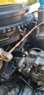

2nd picture is using copper wire to align the stater with flywheel. 1st picture removed wire and used bolts and aluminum plate to secure the starter.
