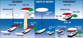

Correct, the three lights are ON when under way at night. The stern light becomes the anchor light when boat is at anchor. All three lights are controlled by on switch ON-OFF-ON (ON Nav lights-OFF-ON anchor light only)
Jeff Fro
Nov 17, 2017
202
I'll be mounting an anchor light on top of the console/t-top. The rear light is actually flush with the back of the transom and won't be able to be seen by someone coming from the front when anchored.
Then the white light on top needs to be ON when ever boat is running at night

The stern light is the same as the "power boat under power" upper pic. So it looks like I will have to have all 4 lights on.
