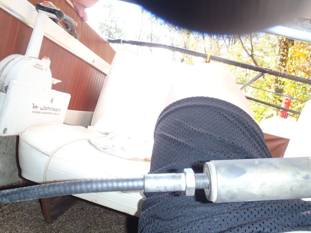

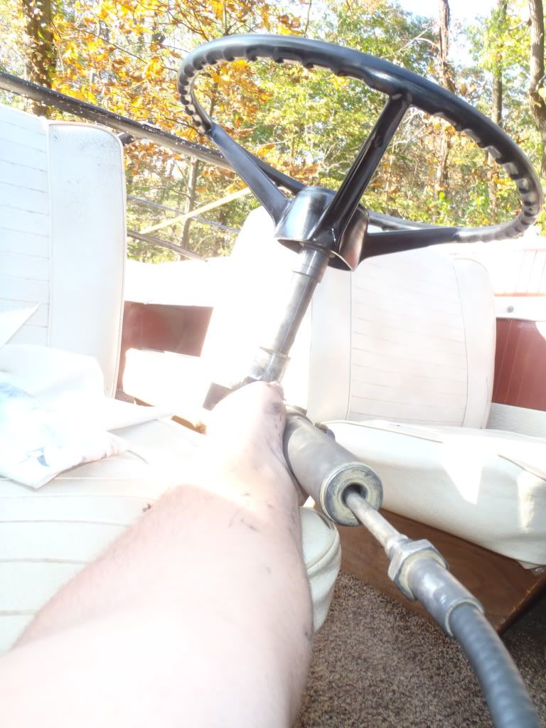

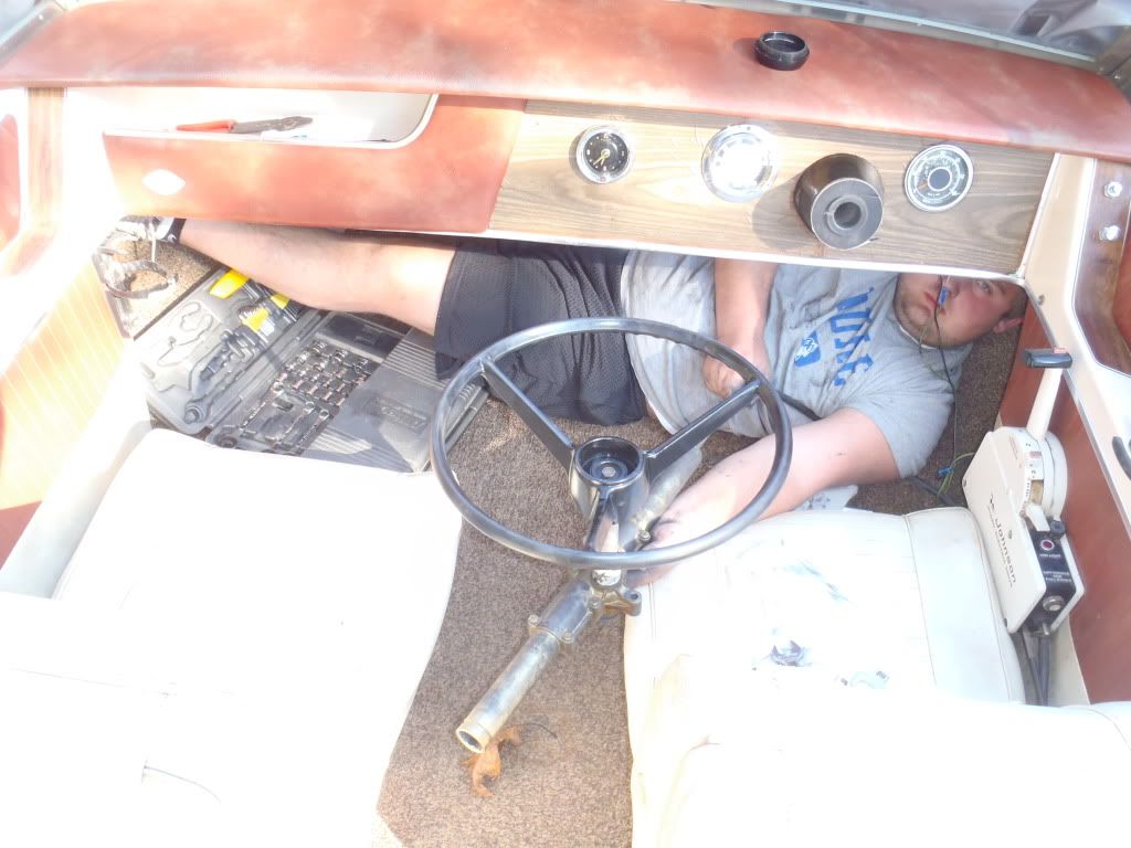

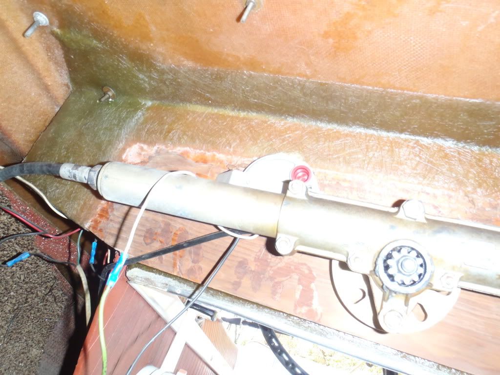

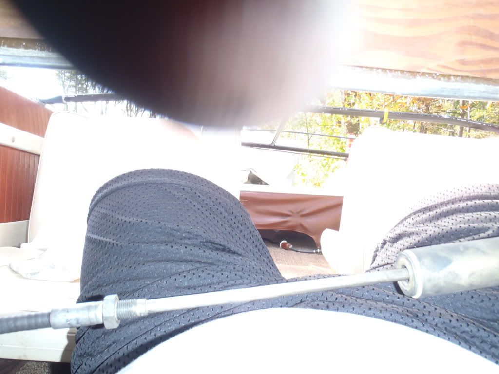

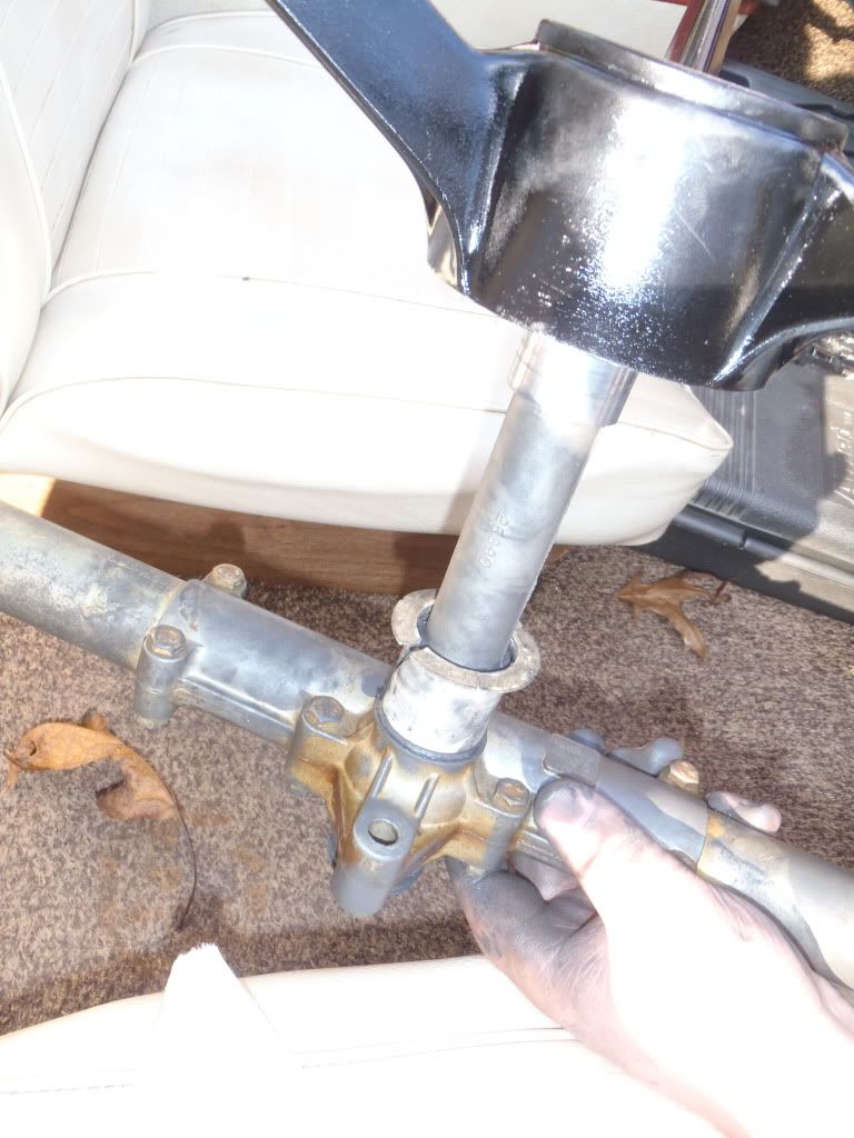

Bondo I like your idea but if I can save 115 bucks I am going too. Also I was able to remove the cable. after unbolting the cable from the helm we saw that the gears moved fine in the helm. Heres the pics:
http://i1108.photobucket.com/albums/h401/Cowboyup94/PA160101.jpg Heres the helm still installed
http://i1108.photobucket.com/albums/h401/Cowboyup94/PA160106.jpg In this picture we took the helm out and unbolted it
http://i1108.photobucket.com/albums/h401/Cowboyup94/PA160105.jpg Fully expanded
http://i1108.photobucket.com/albums/h401/Cowboyup94/PA160107.jpgHeres the gears
http://i1108.photobucket.com/albums/h401/Cowboyup94/PA160108.jpg after messing around we hooked the wheel back up not connected to the dash but up to the helm but it wouldnt turn or move then.
http://i1108.photobucket.com/albums/h401/Cowboyup94/PA160109.jpg heres same thing different angle
http://i1108.photobucket.com/albums/h401/Cowboyup94/PA160111.jpg different view with close up
So for today we found out a few things
1:gears work in helm
2:with cable unbolted the ram thing inside the helm moved but the ram in the back of the boat did not
3:There is no lack of grease (i know because i was covered in it) or chaeffing on the metal gears
4:Cable steering systems suck!
Can anyone think of anything or is it just a bad/frozen cable?
