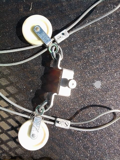

steering_shift 011.jpgThanks!
My problem is, I am not sure how this is attached to the motor. I have two springs with pulleys attached to them, so it looks like the cable were fastened solid to the motor (how??), but I am not sure.
Here are the pictures of the motor and all hardware (+ 2 additional pulleys in the fornt of the boat).
Any ideas?
Thanks!
Hana
I was only able to upload one picture. Here is the link to the other:http://www5.snapfish.com/snapfish/t...otsc=SHR/otsi=SALBlink/COBRAND_NAME=snapfish/

Re: steering reinstall
Looks just like this. Ebay sometimes has em. If not pretty easy to fabricate.
