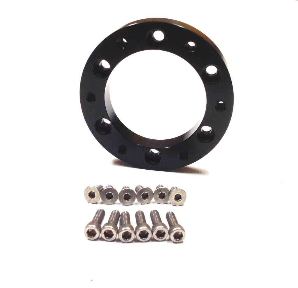

I picked a Momo wheel to replace the original wheel but ran into a bolt size and pattern difference...Both are a 6 star pattern but the new momo use's a slightly smaller bolt and the pattern is slightly different just enough i cannot refab it..So does anyone know of a adapter plate ...Ive seen many but there are so many different pattern's

That was my first thought also..but the pattern is off by 1/8" just enough to make that improbable..i guess i could jb weld the holes and tap new ones but there has to some conversion adapter out there.

First one is to run screws into the threads using red loc-tite...when it sets up, cut/grind off any portion of the screw that protrudes flush with the either the steering wheel or hub... this gives you basically a blank template with which to re-drill the new mounting bolts...then drill and tap the new holes as needed...
The other is to make your own adapter plate out of a piece of 1/4"-1/2" thick aluminum...that gets a bit more involved and works best when changing to a completely different bolt pattern, say 4 bolts to 6...otherwise you end up doing almost the same thing as above, drill/tap/grind, remark for the other bolt pattern and repeat...

Solved Amazon.com: 1/2" Conversion Plate to fit 6 Hole Nardi Wheel to 6 Hole MOMO Adapter Black: Automotive
Nardi wheel
Momo wheel
Notice the bolt pattern both 6 but one is veritcal
