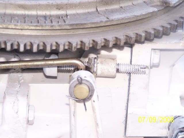

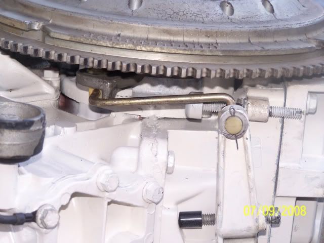

yes 18 degrees at about 3000-3200rpm but the reason i think it wont get anymore is because the timming arm hits the stop....the stop is adjustable (threaded)....but i did the timming in the driveway with wot and timming was dead on but put it in the water and 3000 rpms and 18 degrees is all i get....could i put it on the water and increase the timming a couple of turns and see if rpms and advance go higher or is there a better way ??? thanks again

Where is the timing stop screw? Almost all the way in or out? Or about in the middle?

Re: still no wot rpms
here are some pics of it
That's about right. Are the carb butterflies going horizontal?
