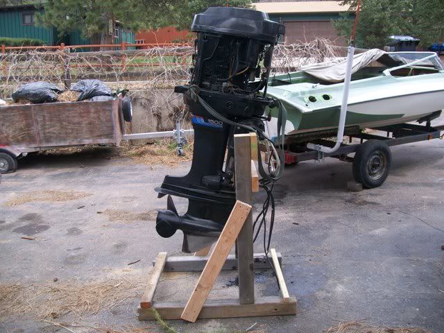

Just build one of these for about $20:

The stand is the way to go,put some old wheels on it.
Notice the holes cut through the sides of the 4x4 bases......that's where my axle's go through :D
