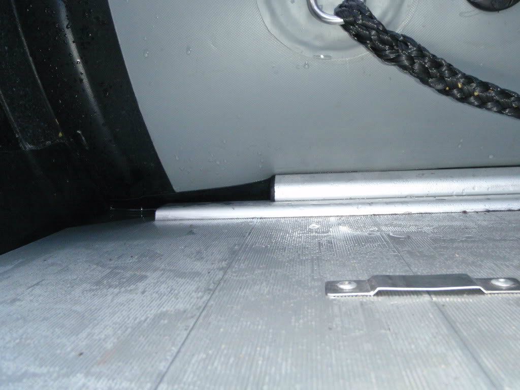

This is the ideal one piece long side joiners any large sib will want to have installed, forget all about hinge floor effect and bending issues at choppy seas, perfect floor rigidity at all floor lenght, outperforms any other standard 4 piece side joiners. Complete deflated sib, oars under floor, soapy water and patience are key to install one piece long side joiners :D
Centered glued patches protects side joiner's end caps against tube abrassion issues and keeps joiners's from traveling towards transom while boating, on larger sibs you could glue extra middle patches between transom and bow to tight better side joiners against middle tubes. Just need to have a top inflated sib to work as expected.

On larger sibs you get 4 pieces, 2 short, 2 long packed inside sib's carton, right. All side joiners which are one piece 6 mt long are factory cut to size to match XXX model floor. As we import factory direct not an issue having them conviniently cut to our sib size tech specs.
