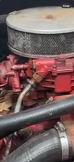

I was checking the screen in the carburetor for any debris. Went to tighten the inlet fuel nut into the carburetor, and tightened it a little too tight. Stripped the threads and now fuel spews out of gas line. Needing recommendations on how to fix threads on carburetor so I can still use original fuel inlet nut. I tried going around looking for heli coils, but no luck. A person said since that since the threads on the inlet nut are compression/ tapered threads, a normal self tap will not work. Don’t know if I should just self tap the carburetor, and use liquid thread seal, or go the route to purchase heli coils

Ayuh,....... I see 2 options,..... The Best, would be to find a used carb body casting that ain't stripped out,....
I don't see taper, nor a compression fitting,...
I believe, originally, there was a sealing washer 'tween the brass, 'n aluminum casting to seal it,.....
The line, 'n it's nut are plain ole flare fitting,....
If the flare seat in the brass fitting is undamaged, so it'll seal,....
I'd dig out that screen, 'n toss it, fuel filters are for cleaning the gas,....
Then glue the brass fitting into the carb body,.....
After yer glue of choice sets up solid, screw the line back in-place, check for leaks, then go boatin',.....
Maybe JB Weld, or something like that for a glue,....
'n Always use 2 wrenches when removing the flared fitting,....
1 to turn the flare nut, 'n another to fit the brass fitting it screws into,....

This is a challenge and while I have never tried to do this, it occurs to me that anything less than 1000% positive of no leaks is not worth it. Leaking fuel on a boat that could result in a fire is not like having a fire at home where you can simply walk outside. I have read in other threads that reconditioned carbs are not that expensive. Post your info about boat, motor and carb and there are folks who can help guide a replacement carb or provide other ‘fix it’ info.

I have a 4.3 Volvo engine. I entered the model number on the Volvo penta website, and the carburetor they have listed is for a V8 Volvo penta. IMG_5038.jpeg

Gasoline leaking out becomes drops dripping on hull bottom. which evaporates into GASOLINE FUMES !! That can fill up the boat............. Do the carburetor body replacement routine.
52,316
I would get a new carb.
if it was a holley 4150/4160/2300 series, a new bowl would be all you need.
no need to be more than one finger on the wrench to tighten an inverted flare fitting.
that little screen in there does nothing. it has a rating of 150 micron. which means that large chunks make it thru. the 10 micron filter you have by the fuel pump is your filter.

If you have sufficient room on the carb body, you could drill and retap for a flush bushing. You would need to find a flush bushing that fits the fuel line, and get the right tap and drill for the male part of the flush bushing.

There are some numbers on my current carburetor, and when I search them up, they bring up a whole different carb wher the fuel inlet is in a totally different position. So would need new fuel line as well if I went that route. These are the numbers I found on the carburetor. IMG_0105.jpeg

52,316
the issue is the split-top 500 CFM carb was used for only a very very very short time and was replaced with the much less expensive 2300 which shared so much with the 4150
there is one on ebay. https://www.ebay.com/itm/266999246488
39,466
Replace the carburetor body.----Gasoline leaking on a boat is an issue.-----Or add a parachute to the safety inventory on the boat.
