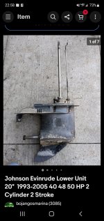

This is the picture they provided as part of sales pitch on ebay...it looks way better in person. I'll be swapping out the anode for the prop shaft...as the new used ones is pretty well used up. It turns well...the paint is rough but in person it is only the paint... corrosion is minimal. I started prepping it for install... then realized I didn't have any lower lube...off to Walmart.
This took 3 walmarts to find some available. Walmart seems to be discontinuing the quicksilver gear lube at least locally....had it clearanced at $3.50 quart at the one location it was available. So I took everything they had cause that's an amazing price and with 2 outboard boats and a Volvo in out that I have to service as well...yeah I has a problem with 2 many boats according to wife. Anyway I use a lot of lower lube and marine grease...and such.
Will take some pics tomorrow as I clean things up... rebuild the water pump...pressure test the lower... refill it. Install it... and if...if God is willing test it on the lake...perhaps Sunday. I still have to go get paint... I'm out of zinc chromate primer...so that will be part of tomorrow's work too... find primer... get a pint of paint and reducer and hardener...
Lol such is life.
