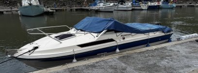

Hello!
I have recently purchased a Sunseeker Sports 21’ According to the seller it’s a 1985 but I contacted Sunseeker directly and they have said it was a model built between 1977 and 1980.
Anyway, I plan on restoring her but also adding a few modern touches along the way. My first large job was to remove the carpet, plywood subfloor and remove the original fuel tank. (She would of originally had an inboard motor but it’s been professionally converted to have an outboard motor) The original fuel tank was all disconnected and now is just dead weight.
Unfortunately it seems that most of the stringers are rotten. I’ve read on multiple forums and articles that you should replace like for like. Same active core, same glass etc… But the tops of the stringers haven’t been glassed over like I have seen on stringer replacements on other boats. Is this okay? It also looks like the original glass is quite thin.
I’m replacing the Stringers with 12mm Marine Ply as this is what is currently in place. I’m a little stuck on which fibreglass to use and how many layers.
Any help or advice would be greatly appreciated!

Thank you Mike, I appreciate all your insight.
@airshot, I didn’t realise the stringers were in this condition unfortunately, the floor felt sturdy and sound!
The work actually excites me, I’m a perfectionist and I’m really looking forward to putting a stamp on this boat. The different types of glass and resins is a bit of a minefield but excited to learn it!! Unfortunately here in the UK most used boats are fishing ones that are more suited to our waters, I wanted a cruiser that can both!
Bust Out Another Thousand 🤣
Sunseeker26
Aug 11, 2026
5
She will be a fantastic boat once her bones are restored! A lot of the original features are there so she’s worth it!
