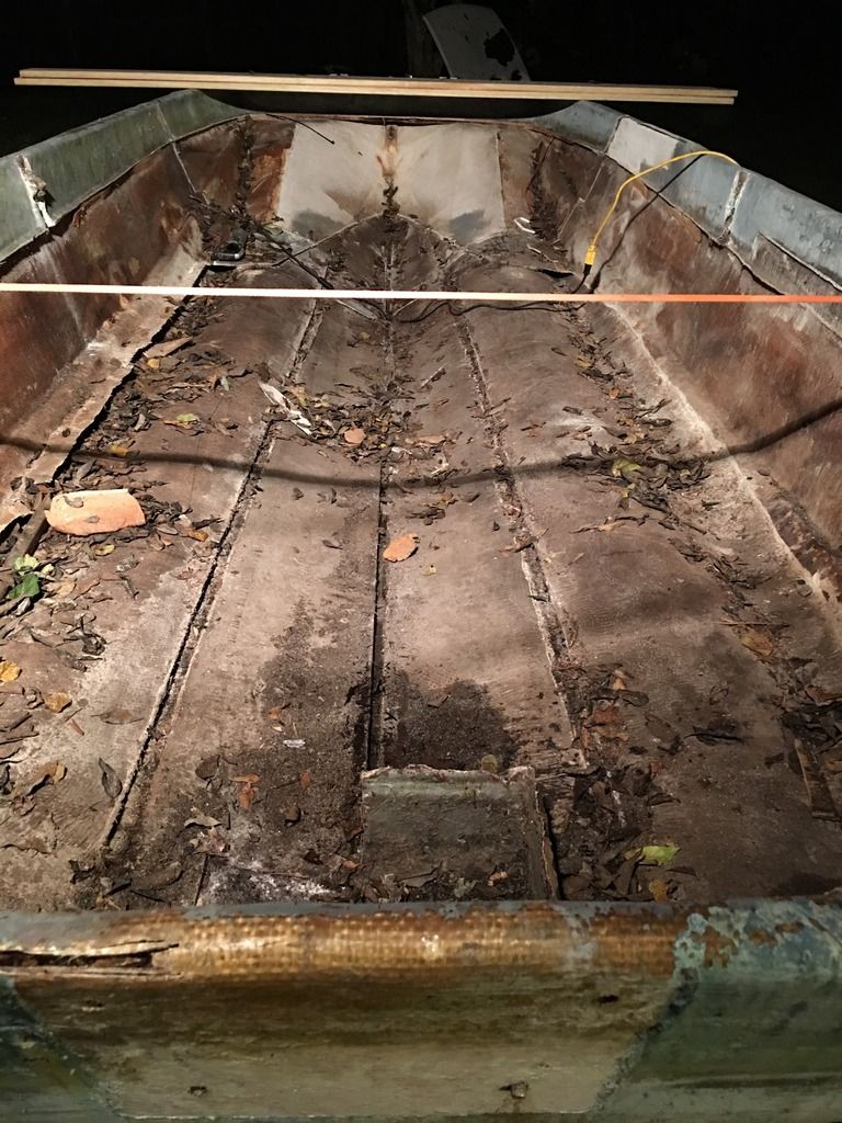

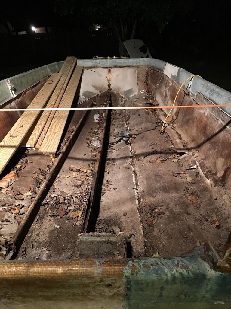

Got a little free time,cutting out stringers and transom.
I picked up so 1x6 deck boards(not treated)chose the grain carefully.
Ill use these for the stringers.
Im still a long way from installing the stringers.
Gonna try to sand n strip entire inside before monday.next week cut n fit stringers then glass by next week end,then transom and floor.

Yep.....im broke and only have 1 grinding disc,2 used tiger paw sanding disc.
Ill try to trim away what i can.
Wound up working till 9pm....put a big dent in my plans.
Let the grinding begin !

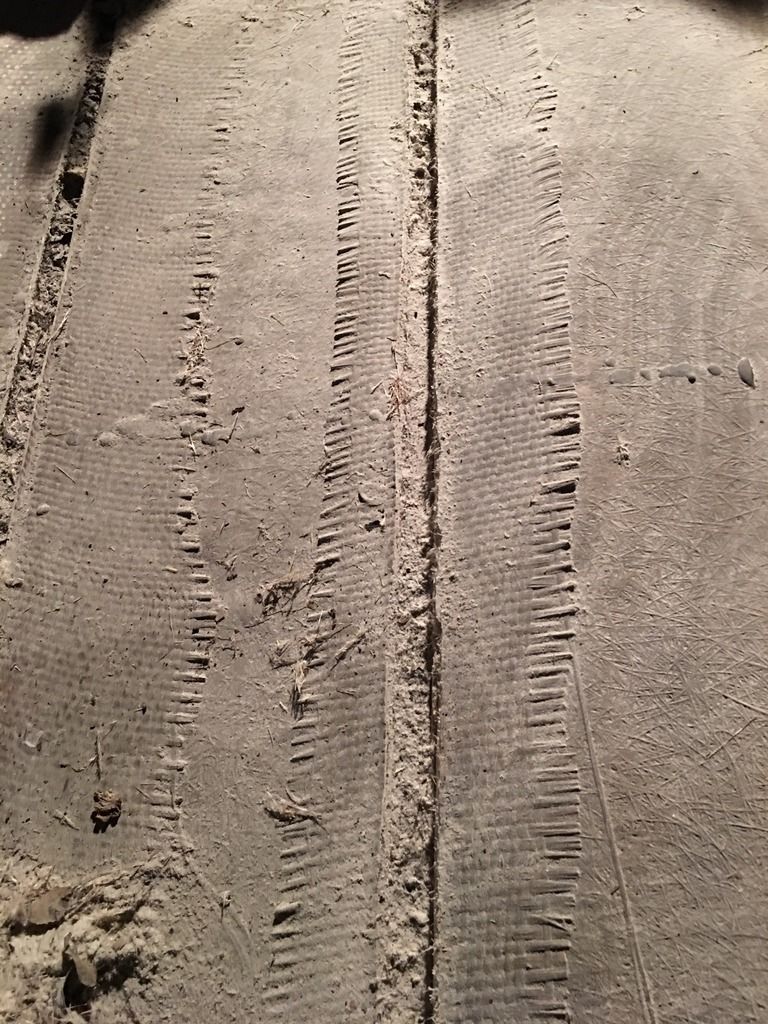

The grinding and sanding.....followed by lots of itching begins.
Gotta do just about all the interior......the part we all hate.
igotit
Oct 30, 2015
134

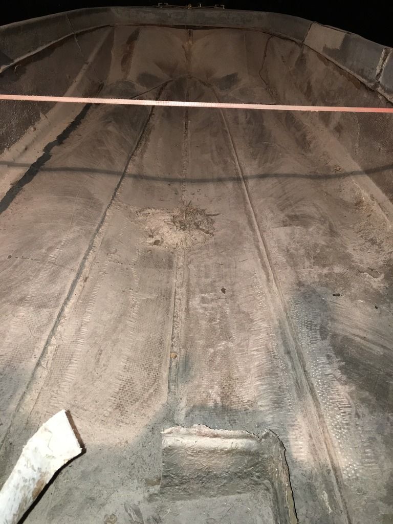

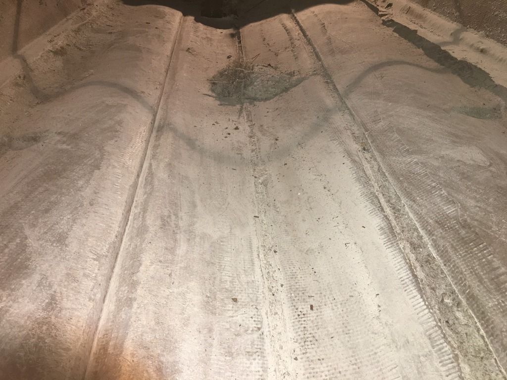

Got 1 stringer valley almost done.
Probally best to remove all the old heavy mat....but i think ill be fine just sanding her down and making a clean valley for new stringer and matt.

A trick i use to keep the dust in check.
Spray the inside of the hull with a mist of water,airborn dust will stick to the water.
Just remember that water and electricity arent good friends.
Gotta use common sense.
With that said id still recommend a resp.
