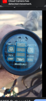

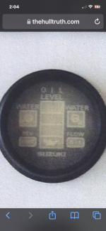

Does anyone know anyone who might know someone who might be able to locate a set of gauges for this 89dt200 eXante? Or even parts that connect to the comlink system? I guess the most important gauge I’m looking for is the warning one that has the water left and water right, oil etc. ones like these?IMG_1893.pngIMG_1889.png
52,324
pretty sure that gauge is available thru the Suzuki dealers. its custom made for Suzuki by VeeThree
