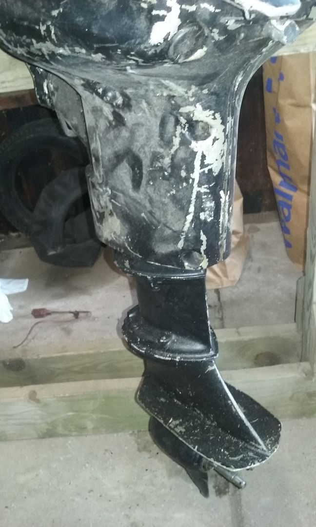

I want to make a long shaft out of a short that runs but has a crack in a housing and a long that has been picked up art for parts. Would it be best to swap heads or fix the crack somehow and swap lower units? Any help would be appreciated thank you.
F_R
Honorary Supreme Mariner
Jul 7, 2006
28,226
I believe that crack can be welded.

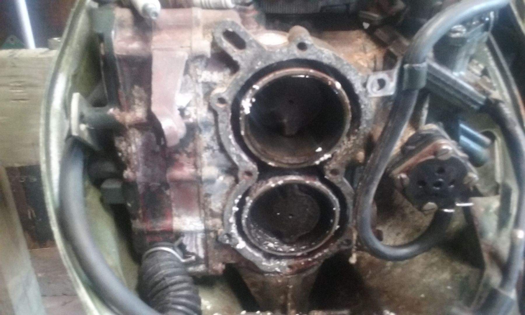

So now I found a blown head gasket and water in the cylinders. I guess I can try to clean it up somehow?

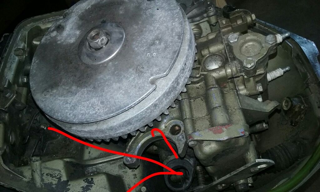

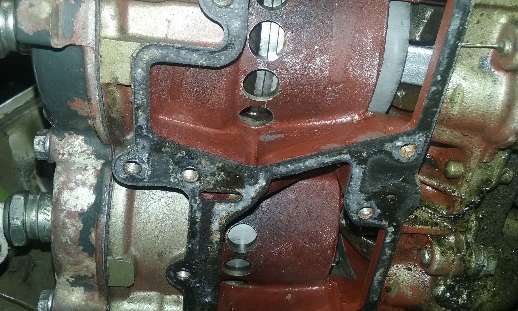

Switched everything over to thec'73. She fired right up but now I have a leak here??? Now what do I gotta do :(
39,981
That hole would normally be covered by the recoil starter.--------That has a gasket to seal that up.

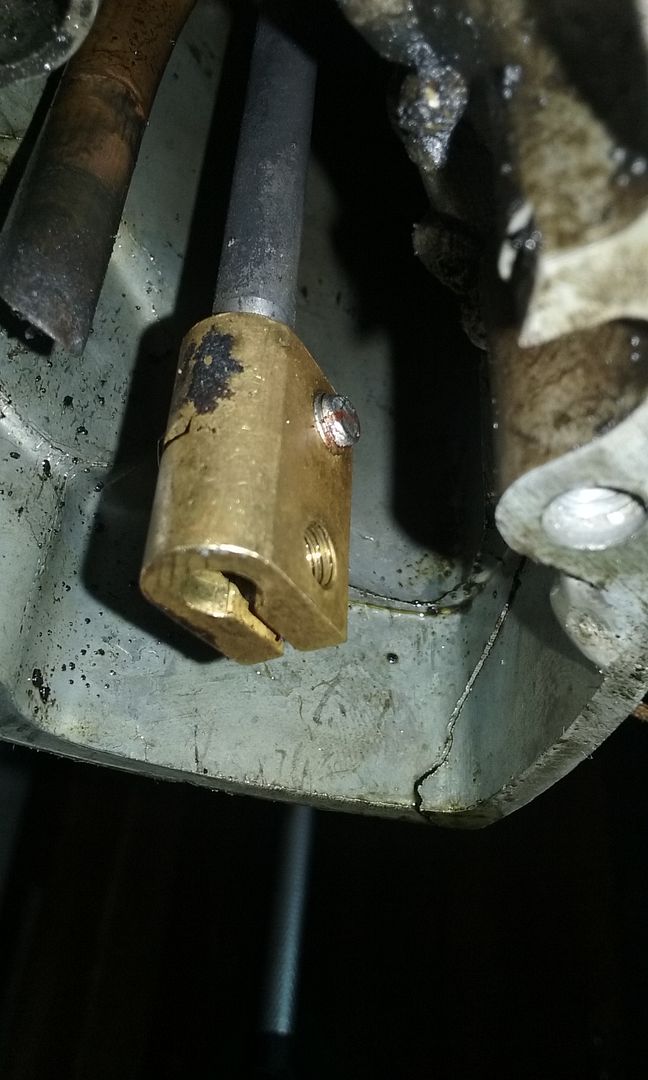

Still can't figure out this eyelet. How the heck does Iut come out? Would something like this be in the shop manual or a service manu al for this exact motor?

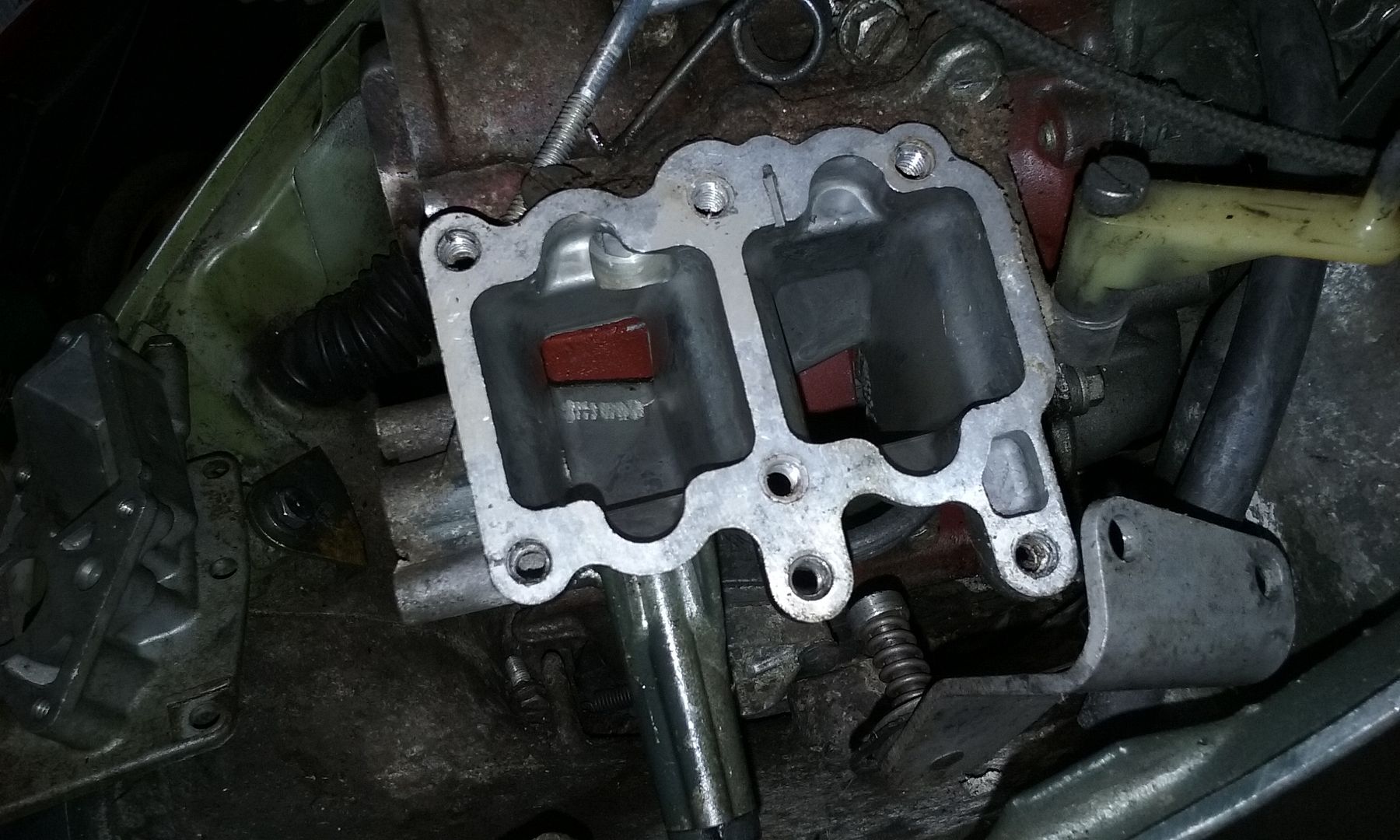

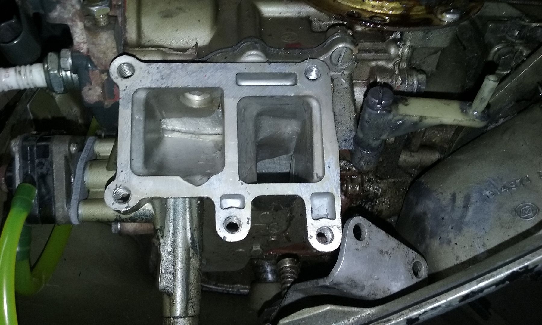

Ran into a new problem. The carb on the '70 isn't the same as the '73. Would I be able to make this work somehow? What's stopping me is I'd like to just use the whole assembly from the '70 but it has a fuel connection where the '73 does not. If I can't use the whole assembly could I use just the carb assembly from the '70 and use it with the '73 intake? This is turning into a mess :(
