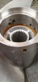

On my DP-SM I have placed anodes on the trim cylinders rams after having to renew both cylinders due to pitting on the rams. The body of the cylinder is part of the Volvo Penta's Active Corrosion Control, but the rams and Pivot pins are isolated from protection by the plastic bushings in the leg.
Furthermore my props are suffering serious corrosion due to the nylon sleeve that also Isolates them from the Volvo Penta's Active Corrosion Control.
As far as the corrosion on the body of the Leg after 23 x 5 month seasons immersed in salt water it is not too bad.

For what they cost it is worth a try. If you look at the picture you can see that I cut a little of the Pivot Pin support flare to gain a bit of clearance. The first set I tried were a bit more barrel shaped they are 3/4" or 19mm propshaft anodes.
