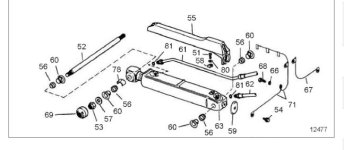

  • Genuine Volvo Penta Outdrive Trim Tilt Bushing Part Number 3853423
  • Fits Volvo Penta DP-S, DP-SM, SX-C, SX-M sterndrives
  • Set includes 4 Bushings
  • Factory OEM Original Equipment
there are plastic bushings that slip into the cylinder ends .Need to look up transom housing in the vp schematics1661704296162.png

The plastic bushing is to be inserted in the outdrive housing, not the trim cylinder.

I know of the plastic bushing that goes in the gimbal. I was refering to the brass bushing that is in the rear of the cylinder.
Nope, look it up in the SM. Maybe on the newer rams but the older style go in the ends of the rams also
Just saw the video, your ram is different then the job I just did .
