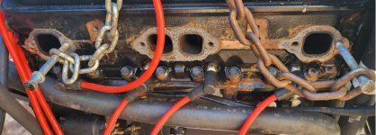

Guys here is my dilema. New engine 5.7 vortec carb, block 880 casting with less than 10 hours was taken out of boat due to leaking oil pan gasket by the timing chain cover. Engine has a noise under load that comes and goes, not yet determined where. Long story short. Rust signs where detected of leaking from the head gasket outside of engine. Now my question is "would" an internal leak cause the noise being produced under load. So far no water in oil. Engine has been barely broken in. Outdrive was removed to discard bearing or u joints and still present. Does not sound like lifter or rocker arm tick. I know diagnosing over the web is not viable and i dont have a vid of that so i would have posted it. But any info regarding test that could lead me down a certain path would be appreciated.

Yes, new manifolds and risers installed. The boat was purchased with a locked 5.0 and swapped over to a 350. This engine was has a tempestous story. This is the 2nd time out of the boat. This time is because the oil leak but noticed the corrosion on the outside of the new head and was looking for possible answers as to the noise under load possible link to water intrusion. At least still undetermined if interior head gasket is compromissed.

Pull your plugs. If one is really clean or has water on it, you have an issue and should pull the motor

Thanks scott, will check the plugs tomorrow to get a better idea. will try to record the noise and post back.

Probably either a lean rattle, or hydro locking from water

Might be worth pressure testing cooling system. Recall seeing where head gasket weeping into combustion chamber would make a tick as engine speed increased. especially thinking this if you are seeing head gasket externally leak…

Reman. On another note i placed my hand on the dizzy as i was trying to turn it and with all wires on and tight it gave me a hell of buzz.
53,252
Reman. On another note i placed my hand on the dizzy as i was trying to turn it and with all wires one and tight it gave me a hell of buzz.
either a wire boot going south or bad wire

Update, plug wire cracked at boot in dizzy. Wires and dizzy replaced. Now off to the clacking rockers.
