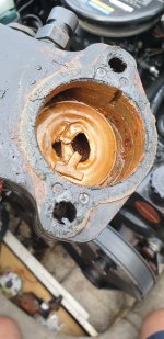

So, im not a mechanic but pretty sure this thermostat looks rooted. Isn't there meant to be a spring?? Where on earth would it have gone? Rusted away completely? Far out, wasn't expecting to see it this bad.
Im ordering a new thermostat. Will let you know if it makes the gauge work (and maybe the boat will run better if it warms up to a normal temp)

I’ve never seen one that bad even here in salt water!
That looks like someone tried to use an automotive one in a marine application

That's bad, the gasket has some kind of gunk on it which is having issue with the electrical grounding of it.

Just updating. Replaced the thermostat today with new gaskets (with the brass lugs) and the spacer per the parts diagram. Cleaned it back to bare metal.
At first I still wasn't getting a reading but after a few minutes t-stat must have opened and bingo, got a temperature reading. Eventually settled at around 160F.
Beautiful! Will water test tomorrow. Interested if a noticeable difference if the engine gets a bit warmer.
So, I'm still not sure if it was a bad ground or the engine just not getting hot enough, but hopefully this helps someone else.
