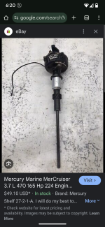

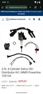

The distributor was never used in a car As the Mercruiser 3.7 was dreamed up at mercury by taking the pistons and head from a Ford 460 and making a custom block and crank with a custom cam. It also is completely different than the 3.0
Mercruiser DID have them custom made.
The Mercruiser distributor is a cross between parts of the shaft of a Ford small block, the body of a Chevy vega and mechanical advance parts from an international
The starter is a custom marinized international 304 V8 varient

I'm curious about this.. however, just to clarify,
Your pictures are showing how the 3.0 is different from the 3.7,,
and how that 3.0 dizzy wouldn't work with my 3.7, correct??
Saying this since I've had mixed feedback that these electronic dizzys both exist and don't exist. I see how the 3.0 doesn't have that spring loaded square rod - I'm not sure of the purpose of that rod, however.

correct, you can not make a 3.0 distributor fit a 3.7 short of a machine shop and custom make one.
the 3.7 liter does not have an electronic distributor anywhere. the only thing that exists is the pertronix point replacment trigger, however the distributor still has the mechanical advance.
hundreds of hotrodders would love to have an off-the shelf solution, me included. for dropping the mercruiser motor with an aluminum head and some deck work into things like a 1932 ford, etc.
