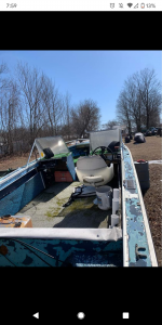

Here is the $600 boat I can get. Thoughts on this??? It's got alot going on in these pics..and it's 3.5 hrs from me too...but I'd like to salvage the project...combine the best of both boats and sell off what's left.
Obviously it's been used and abused. I'm told the goop randomly not sticking very well underneith is silicone and that the seams of the aluminum are not separating or elsewise as it sort of appears.
I asked for the extra pics (shown here) of the hull and the worst spots on it. The scratches from the bare wood bunk appear to be just surface...
Anything else I should ask for for pictures?? My intention is to rip it down to bare hull anyways, but I'm pretty gun shy now that my first foray into boating has unexpectedly gone so badly, finding my hull to be so compromised.

For $600 Id pick that other one up regardless lol. Thats just me though. Then Id take the best of both and put it in the good one, throw all the pieces leftover in the other, and list it for $500 or $1000...
The original hull is fixable from what ive seen here but thats a lot of work. For only $600 and you could avoid it? I would. But i wouldnt trash the old hull. Definitely keep that 70 johnson. For all you know the new hull has a rotten transom which you wont know about til you take off that merc. Im still voting for 2 boats haha.

That 2nd boat is probably cheap for a reason...quite a gamble given the "flex seal" spray bomb repairs. It's a Vt boat and there's a good chance that it has seen saltwater.
The corrosion that you've shown doesn't look too bad to me...yet. I would go around and test all of the corrosion pits with a pick by seeing if you can push it through. It's pretty easy to add exterior patches to sketchy areas.
I'd then move as much corrosion as possible using mechanical means (I like the orange Nyalox cupped brush)...a dremel works great for digging the white stuff out of deeper pits.
I had alot of corrosion on my 18' SS. Once the visible corrosion was removed mechanically, I went around in sections, treated the pits with West Systems Aluminum Etch Kit 860; this is for cleaning and adhesion. Once dry, I filled the pits with Marine Tex epoxy so that water doesn't pool there in the future.
I'd also strip the bottom paint to see if there are anymore surprises!
