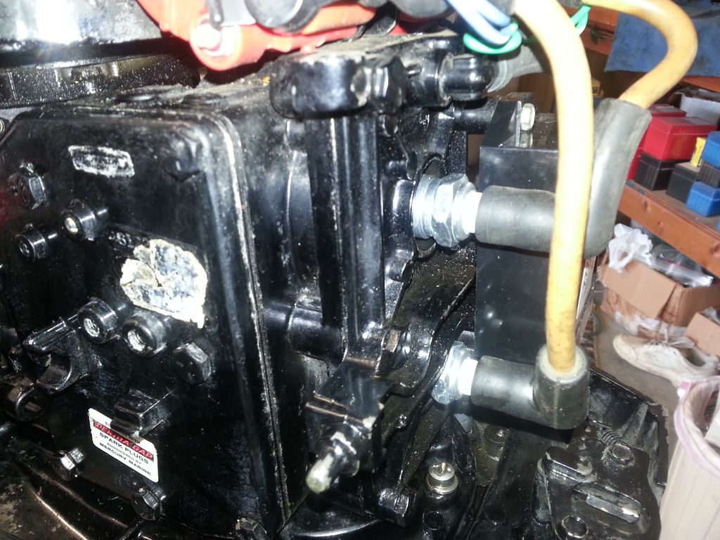

Well looks like you covered the bases pretty well. The 9.8 may not have a thermostat but hovering around 140 suggests it does. 143F (start of opening cycle) is a popular pellet temp for Merc. Stats. Follow the hose back from your outlet on the cowling and tell us where it originates. Then get us a picture of the rear of the block as close as you can get keeping it focused and showing the whole rear of the engine at and above the cowling. The distance you used in your video is fine, just move around to the rear and shoot from there, everything else as you have in the video. A picture will do.
