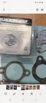

The biggest 1 has 2 metal grommets in it.I was thinking about using the next one.That doesn't have grommets .What do you think

I also cleaned out a cork gasket from underneath the thermostat.And replaced that with the cork gasket that came in the kit oring too tall with that in there for plastic retainer to be level.

Ah, ok, so it had the cork to begin with. Good. The gasket with the metal grommets is for the ones with a temperature sensor or overheat sensor in the cap. You can use the regular one for your application.
