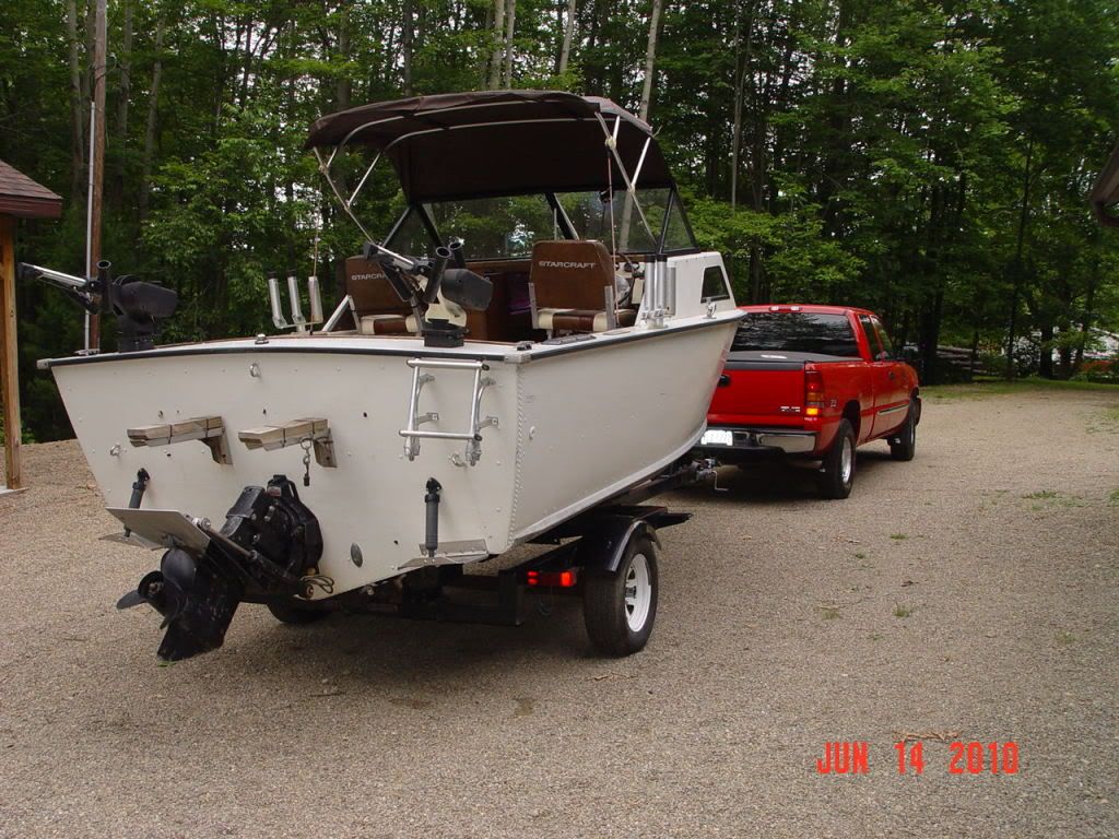

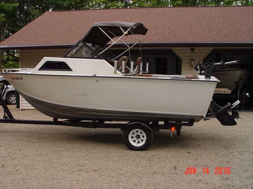

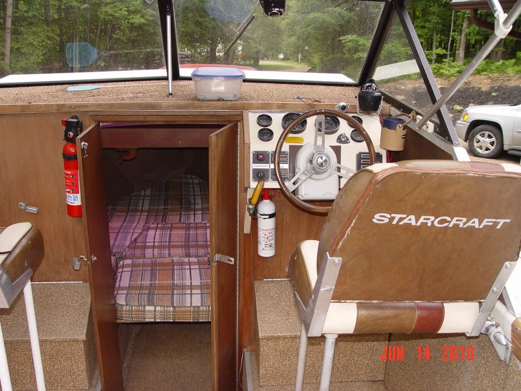

Here are some pics of the boat last year before I purchased it. They don't tell a lot but its all I got right now.
BTW: These are only for the picture junkies. I have noticed a lot of people need this fix. Use it wisely!!!

Ayuh,... I've got a 74 Islander...
The Decks of Islanders are well Below the waterline, by Several Inches....
I hose down with a gallon bucket, 'n let the bilgepump send it overboard...

Wow nice rig, I'm a huge fan of Islanders.:D
What's the length of the boat?

Very sharp reming!

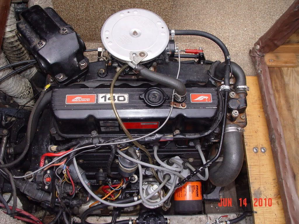

That 3.0 liter in that set-up sips gas. My last trip of the summer was out to what we call the half-hump off the Mass Coast. Approx 15-miles off shore. Seas were flat on the way out and 4-footers on the way back in. Went through about a 15 gallons for the whole day bouncing around to different spots. No need for the diesel. I do need to find the power loss I have though. Just to get me going I installed an 16x11P prop. The 13x15P that was on barely planed. If you read my other posts I have been through the ringer looking for this problem and still can't find it. The previous owner(s) have cared little for her over the years and I am slowly bringing her back.

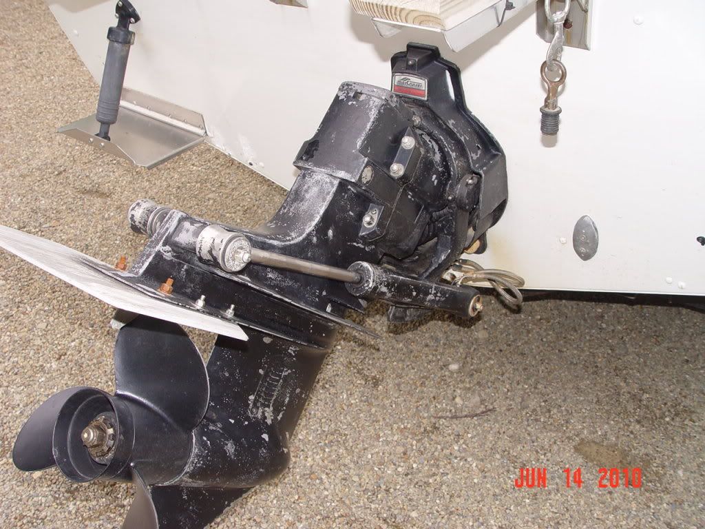

Ayuh,... Without digging up your other posts,...
I'd say it's got the Wrong outdrive on it....
It Should have a 1.98:1 gear ratio,...
My Guess is, it's got a 1.50:1 on it...

Its 1.98:1 ratio. I marked the shaft and hand cranked the motor while counting the revolutions on the prop shaft.
I am leaning towards wet foam or exhaust?? Only places I have yet to confirm.
