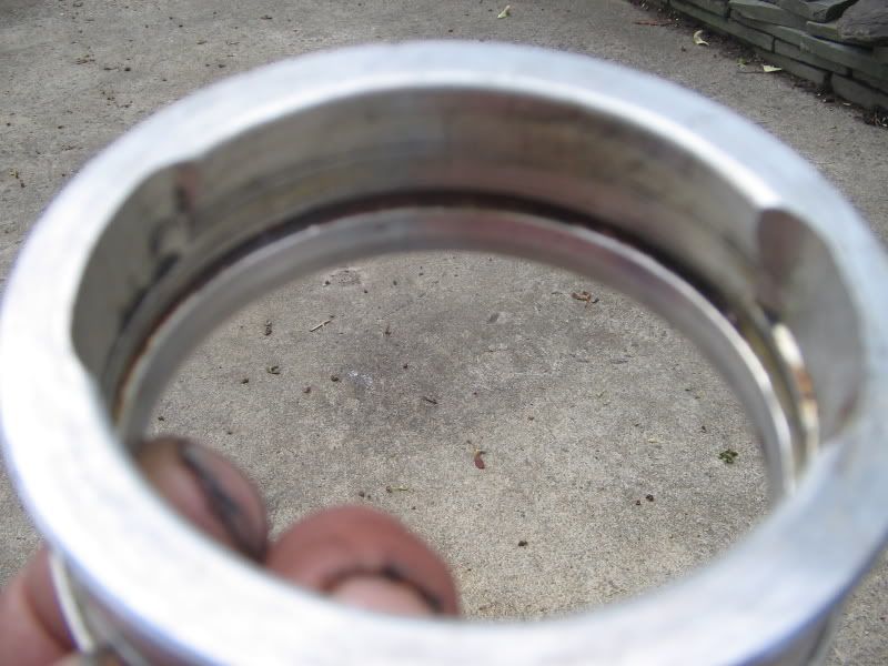

Or is it? Just got a new gimble bearing and there is a grease hole in the outer ring between the metal band but there is no hole for grease to get to the bearing. Shouldnt there be a hole in the bearing that is pressed into the ring that lines up with the hole in the outer ring? Hard to explane but I think you might know what I mean.

Ayuh,...... Welcome Aboard,..... Grease fittin's have been disappearin' for Decades now,.....
The gimbal bearin' is just the latest to go "Greaseless",....
Most of the new gimbal bearin's out there are seal bearin's,...

the bearing is not pressed in. its slipped in between the slots and rotated into position.The way the grease gets into the bearing is from the zerk it goes into that hole in the tolerance ring. inside is a small groove all the way around. The small hole in the bearing rides in that groove. the grease travels around the inner groove until it finds the hole in the outer bearing race and then enters the bearing.
