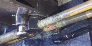

Bigwill41
Dec 21, 2020
I have a mercruiser mcm140. From what I can gather, the cable is a morse teleflex. The cable has a plastic barrel that holds the cable to the engine block. The black plastic barrel has broken in half, and the throttle cable is not working now.
From calling a few local marine shops I am told I need to replace the cable even though the cable is fine. The barrel splits open at the top to slip over the cable so it is removable within seconds.
Anyways, does anyone know where I can buy a replacment barrel, or does anyone have any other methods they have used to hold the throttle cable in place in a situation such as this?
this is a picture of the barrel used on my cable.
Did you ever find your answer I'm having the same problem my shifter cable one
Bt Doctur
Aug 29, 2004
19,489
After 7 years think he got it fixed.
Post a wider pic hard to tell what you have there, shift cable at the exaust manifold or on the top of the valve cover or at the control box
