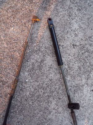

'Preciate the responses guys - I'm sure it's kinda hard to imagine what I'm trying to talk about above so what I'll do is take a few pictures and post what I'm trying to do, and see if it is possible. I'll post in a few moments...

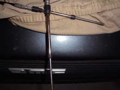

Re: Throttle / remote shift cables
Awright fellas, this is what I've got... In one photo you'll see a standard Teleflex 3300 cable with both ends threaded. I picked 2 of these up today without looking at them prior to walking out of the store. The other picture shows what used to be in the boat... I have to say that it is amazing the difference from the old to new cables! What I had is junk! But is there a way or a kit to get these 3300's to work with my application?
Well never mind guys, I feel kinda stupid now. I go into the marine parts store and they offer a $15 dollar plastic adapter kit to make these cables work on my Mercruiser. Thank god!
