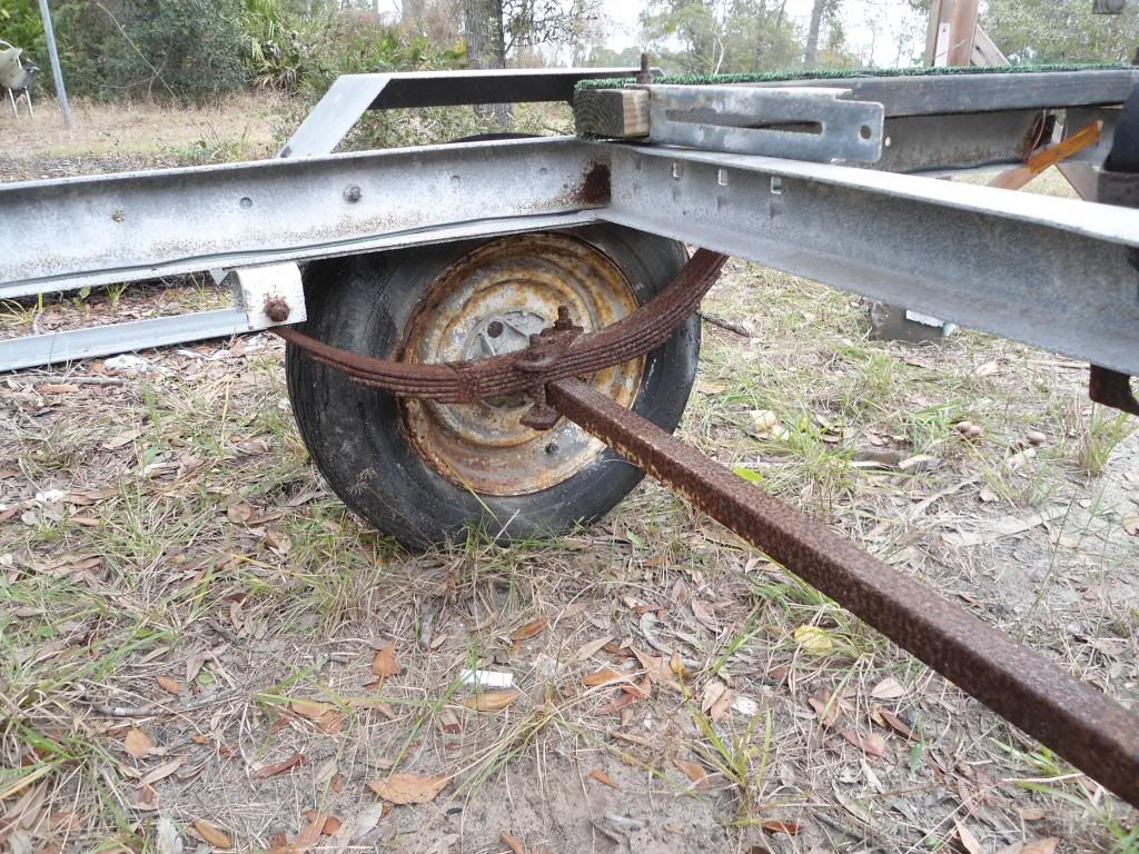

Hey guys . Its at the time in my boat restoration that I need to tackle the trailer . I either need to redo this trailer or find a different one . As you can see it may be a little to small for the boat . I,m sure with your help we can come up with a plan . I really appreciate any advise you guys can give me .
Here is the boat just about ready for the trailer.
Here are some pics of the trailer. Do you think it,s possible to add more channels to the back then slide the axle back some ?
It is a Landcraft trailer . Not sure for what it,s rated for . I am thinking the boat should weigh around 1200 lbs loaded maybe . I,m not sure .

As for the trailer, I don't know about adding anything to the back, it sure looks like it's to small for the boat. You might fishplate the trailer with channel, but by the time you bought all of that steel you'd probably be cheaper to buy another trailer. Even if you did, the axle looks kind of light for that boat.
Please don't think I'm running it down or anything, I'm just trying to give a honest and realistic opinion.
In my personal opinion, I think you'd have more money and work in it than it's worth.

If you have the correct welding equipment and seriously don't mind doing some extra work, you can add on to the trailer and have it fit your needs. It looks like 1 1/2" by 3" channel steel which should not cost all that much. But you would have to also move the axle rear ward to balance the tongue weight correctly. But have at it if you don't mind the extra work. If you do add to the length make sure you back up the addition with backer plates to give it some needed support at the weld joints. But it can be done and look amazing once sanded and refinished. Also add the correct runners (bunkers whatever) to make sure your boat is NOT riding on the rollers when sitting on the trailer properly. Other then that, have fun...

Thanks guys ! I do have a different trailer but it may be even harder to retrofit . It does have brand new axle, hubs ,and springs though .
I have access to this wire feed welder and my soon to be son inlaw is a pretty good welder .
I guess it would,nt hurt to start looking for a different trailer but the budget was busted a while back . :facepalm:

Its more than likely its just me but is that the right sort of a spring holder.
sphelps
Nov 16, 2011
11,508
Re: Time to start trailer rehab
MH , your probably right . Thats the way the trailer came when my brother bought it many years ago . Maybe it should look more like this .

Those leaf springs look a little scarey to me. I agree with the rest. Look for a different and more suitable trailer.
