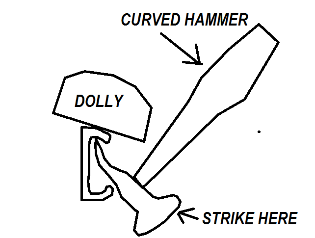

With an assistant you can probably get it back to almost perfect...
The assistant will hold a metal dolly from above...
You will use both hands to use a curved body hammer...
one like this and available cheap at Harbor Freight...
th
The flat curved tip you put up inside the bent part of the rail...
Then using another hammer, bang the face of the curved hammer while the assistant keeps solid pressure on the dolly...
Start out easy and progress slowly...
You should be able to work it back into shape without cracking...
Hope this helps...
