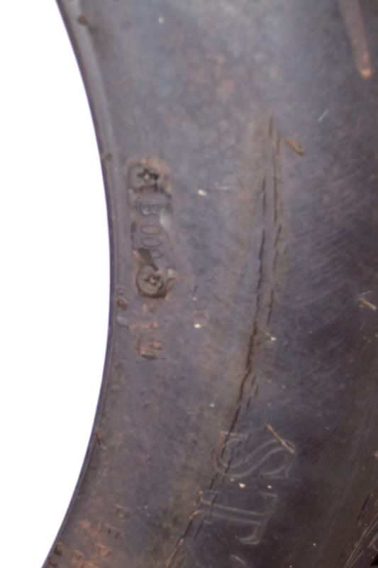

I just noticed on my 2007 model travel trailer that i bought new 5 months ago
that 2 of the tires are dry rot cracking bad!:confused:
It has been parked on a concrete slab with the wheel covers on.No sun has been baking on these tires.Correct PSI in the tires.
This trailer has 900 miles on it.
I emailed the dealer and will see what they say.
I got a feeling they are not covered under warranty..:rolleyes:
Do tire companies warranty dry rot?
I could be the factory used 2 tires on that side that had been laying around the factory for a long time...who knows.
This could be an interesting reply from the dealer..

What is the date code on the tires?

These are the numbers i could locate.
They are Nanco brand
ST 205-75-14
DOT 5Y KCTI 2706
(made in China)...:rolleyes:
On closer inspection the other tires are starting to do the same thing.Even the spare! All in the exact same area about two inches out from the rim going around the tire.

UV rays and ozone normally cause tire rot and usally after MANY years. They would not have set at the manufacturers that long.
With less than a year and 900 miles, these are defective tires that need to be replaced with ones that are not.

I used to work in a bicycle shop, and a customer brought in a bike with tires that were less than a year old, and which looked about the same as yours as far as cracking goes. We were getting set to warranty them, when I got to looking more closely and realized that while they had the same tread pattern, one was a Kenda (Taiwan) and the other was an IRC (Japan). We ended up refusing to warranty them, but we asked the customer where he stored the bike. Turns out he kept it in a shed with a lot of very volatile chemicals.
The scary thing is, he worked in there. If those fumes could rot a pair of tires in six months, imagine what they were doing to his lungs!
Could it be a storage issue? The cracking looks like typical stress you see from tires stored with weight on them while under-inflated.

No,not sitting in the sun at all.I have the white wheel covers over them.
It is stored on concrete pads with the leveling jacks taking up a lot of the weight.Even the spare tire is cracking and its covered also.
Bad batch of tires...

The date code is going to be a 4 digit number. the first 2 digits indicate the week of manufacture and the next 2 indicate the year. For example the date code 2607 will mean the 26th week of 2007. It is possible that you have an old set of tires which would explain what is happening.
Good point. Also, the side facing in should also be cracked. That's not usually a place that gets a lot of UV.

Talked to the Dealer.They are going to contact the manufacterer.The tires have their own warranty.The dealer even agreed they should not be cracking less than a year old.
I will see how this plays out...:rolleyes:
Thanks for the code info Bruce..:) If i remember the 4 digit code was something 06

5 news ones getting shipped out today! All it took was a call to Coachmen.
They are also upgrading me to a US made brand of radials instead of the bias ply.
All i have to do is get them mounted.We have a tire machine at work and a computerized balancer.
They said they will send them UPS ground out of their Illinois plant..:D
That was way too easy!
