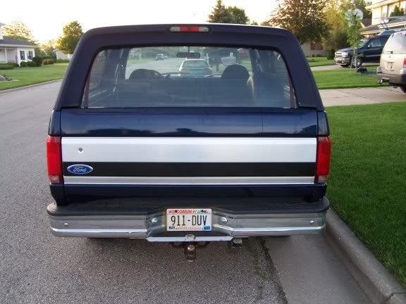

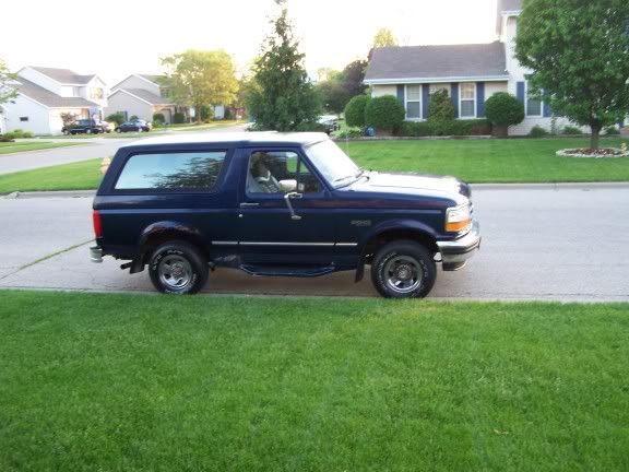

Hey Bob,<br /><br />I found the panels and I can replace the entire back two panels for $450 plus paint. The problem is I have little, no make that no skill at painting, and it is kind of a strange blue/purple color that I just can't match on my own. I also tend to move at my own pace when money and time allows. The back two quarter panels have fairly serious rust, but the doors and everything forward are fine...<br /><br />before and after pics:<br /><br />
<br /><br /><br />Check out the License plate, PW2 probably wouldn't believe it if I didn't have this photo. By accident only, I got the truck about 6 months b4 9/11...<br />
<br /><br />and what is left to do......<br /><br />
