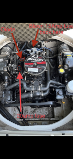

Found this pic on my phone wanted to show you for reference this 15Amp fuse I’ve mentioned. Wondering what it is and why it’s blown. I’ll post back later with wire colours and a better pic but maybe you already know what it would be.

Don't know what the 15 amp fuse is but might be the fuel pump or ignition. With it blown does the motor run

The 15 amp fuses in that area seems to had been more or an additional part of the ignition accessories system that Merc added around that era… it tends to seem to blow if you use other accessories, such as a pump to blow up at inner tube,, raft, etc. from say the helm accessory power plug but if you found symptoms of a wire getting hot at an accessory type device that is motorized with a plunger then possibly it’s somehow intertwined though seems doubtful due to the wiring coloring that I can recall anyways.

I will take a better pic of 15amp fuse tonight and see what colours the wire is and post back.

Now just need to figure out this 15Amp fuse. FT has an idea. I am going to get some pics and wire colours and report back tomorrow.
